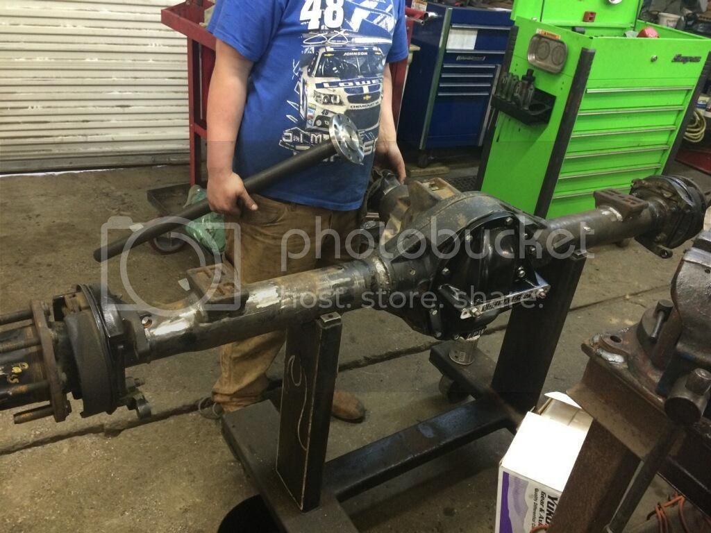

Oh I will. Gman1 did a Dana 80 for his EC/LB 2.5 Class (I think 2.5 Class?) pull truck. He had a shop take a Dana 80 out of a Dodge 3500 and weld the sterling spindles on the 80 and they had it cut to the correct WMS length for the truck. Built up the axle too. I kind of want to follow that route but I'd like to find an axle of out a cab and chassis truck, from what I've read, those will bolt right up to my truck (I'm hoping!)
Yes I had my Dana 80 special built for my pulling truck. Dana 80,s out of C/C trucks are kind of hard to find thats why I went the route I did. Plus I didnt want to miss out on the pulling season waiting on the "perfect axle".
