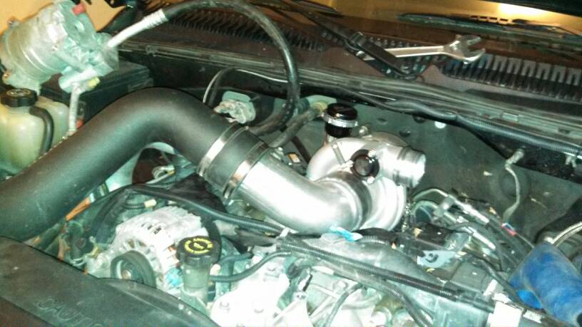

Well after waiting a long time for someone else to do it, I decided to test some of Borgs efr chargers. I decided to go all out and get the 9180 (67.7mm inducer) with a t4 non gated 1.05 turbine housing. It's there largest charger available for the efr series. For those of you that don't already know Borg decided to use what they call gamma ti for the turbine wheel which is half the weight of inconel along with a different design all together. It's water cooled and ceramic ball bearing as well. I somehow was able to get ahold of one so I couldn't say no. Here is the 9180 which flows around 94lb/min lol.
And I know the welds look like crap in these pics but my tig torch was in bad shape. I ended up purging the piping and making a pass over all the welds afterwards but this is all I have for pics. By the end, my torch was covered in tape and zip ties trying to get by. It didn't make it the whole way. My new machine and I get along much better.
So as you can see individual up pipes, and I actually just machined a cap for the gate cause I didn't feel like playing with it at the time lol. I had no idea how the turbo was going to work out with all the talk about them coming apart when the first few batches came out. I ended up welding it up the night before I had to drive to Idaho and before I knew it, I looked outside and saw daylight. I finished at 830 am the day I was supposed to leave. Fired it up, drove to my house and passéd out. Woke up, and just headed out hahaha. Turbo spools very quick for what it is. It's still too large for towing and has a slight dead spot if you fall down in the rpm range but for me to not complain about it, it's not bad at all. Plus i have the larger ar housing. I hated my 64/71 with diverter. This spools almost as fast but the top end is for lack of a better word, stupid. I averaged around 90mph the whole way to Idaho.
I'm looking to pull it off ASAP and try it on a dmax before I get arrested for driving like an idiot.
It feels like compounds up top. It never runs out of air. Just works harder and harder.
I know I haven't explained much but it's late and I'm passing out. Reply with a question if you have any. Thanks

It's 80/76 turbine but the wheel is actually longer. Drive pressure stays low. I just let a buddy borrow my primary for a sled pull this weekend so I have nothing here to mock up my compounds with. Lets see if he can spool a gtx4508r hahaha. His charger let go yesterday. I'll send it to you if you wanna try it. It impressed me. I did have Matt change up the shift patterns because I had it in overdrive at 45mph cause I get tired of hearing the truck. He raised all of them and did an overdrive lockout off the tow/haul button. Truck is an absolute beast. If I wasn't planning on towing the drag truck I would leave it how it is.
I would like to see what it does on another truck because this truck has some goofy fueling issues sometimes and a 64/71/70 with diverter was too laggy for my dd. this starts making boost about the same as the 64 but once you start getting fuel to it, it gets happy. I haven't felt the power fall off yet. I can put myself back in my seat at 90mph and it keeps pulling. It just has a small dead spot if you hit od too early. I feel that it's too big for a 6.0 but some guys like driving around bellowing smoke lol.
I've heard good things about the 8374efr. I have one of those sitting here waiting for my motor on my sti to get back from being sleeved. I might go grab it and bolt it on for a few days. The 9180 is going to go to someone to try. There are two others that wanna try it too. I'm heading east to grab a dmax motor from a buddy tomorrow to make a pedestal and up pipes so we can see what it does with a little more displacement. It should be stupid.
The only downside is that the turbine wheel will start to come apart at 1760 degrees. I've hit 1700 before it lit climbing a steep grade and I watched the temps drop to 1050 and level off. Not wot just steady 70mph in the Sierra Nevada mountains.
