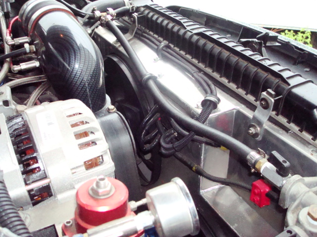

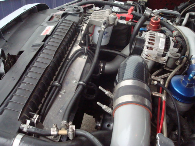

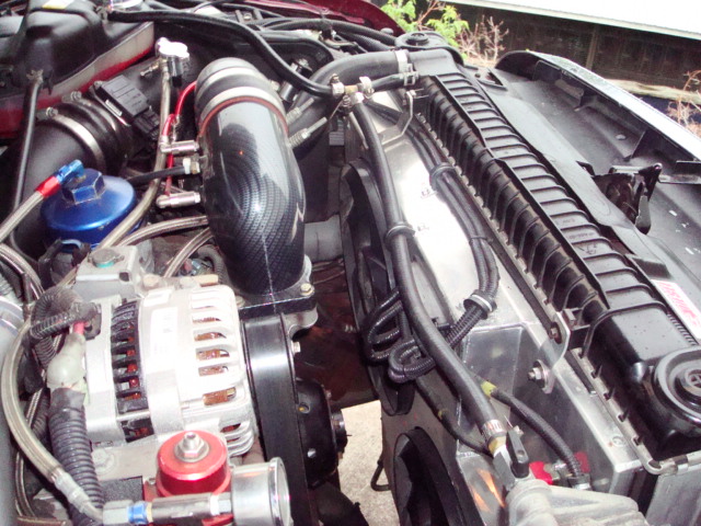

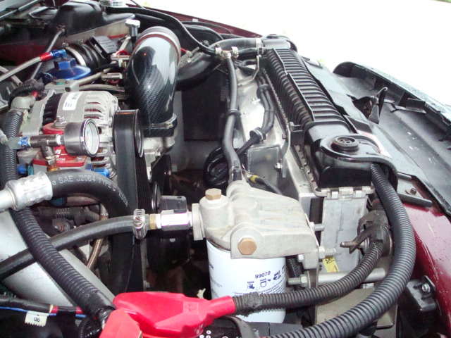

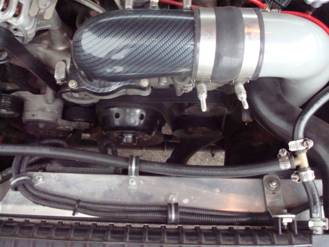

here's mine....

Yea I am totally doing the Flexalite kit over the Derale Fans i showed in the link. I just like how clean of an install it looks like and is proven to work. I would rather not reinvent the wheel if I can help it. I really like how clean it looks on your truck Chris and how much room there is between the fan and the motor.
