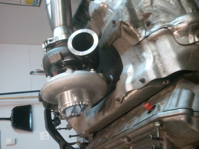

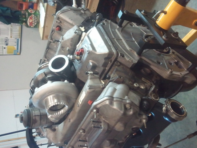

The hp turbo is mounted and started to work on the exhaust to the two lp turbos.
