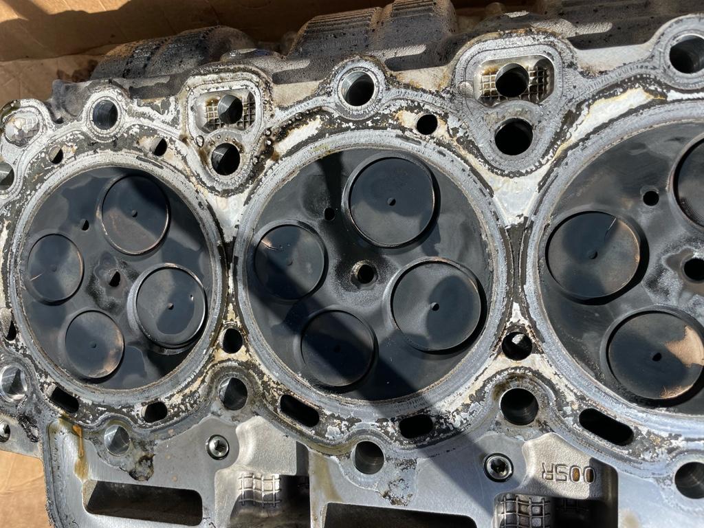

I’m going to compression test tomorrow and see what I come up with, like you guys stated I’m pretty positive it’s got a bad exhaust valve. What kind of damage do you usually find?

For sure cracked valve. I’d recommend replacing both heads. But you could probably get away with doing a valve job and replacing all exhaust valves if cost is an issue.

Cracked exhaust valves were the cause of the popping noise.
