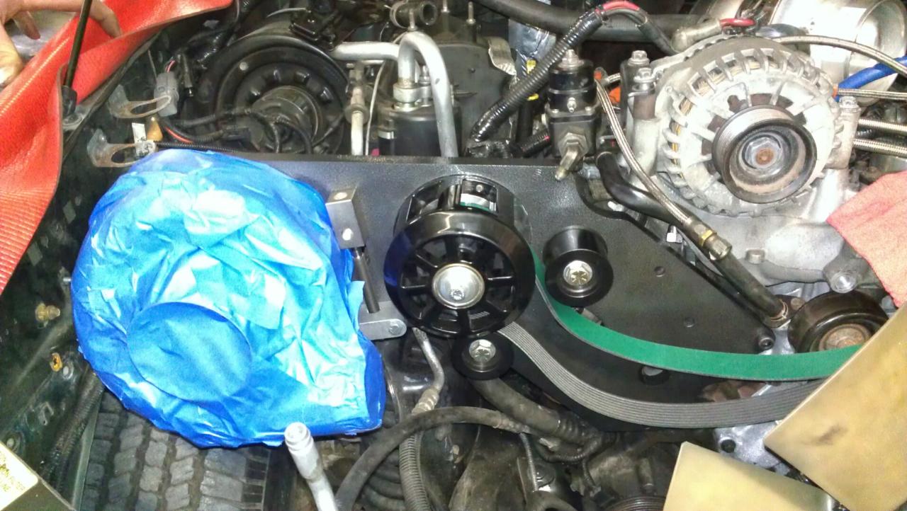

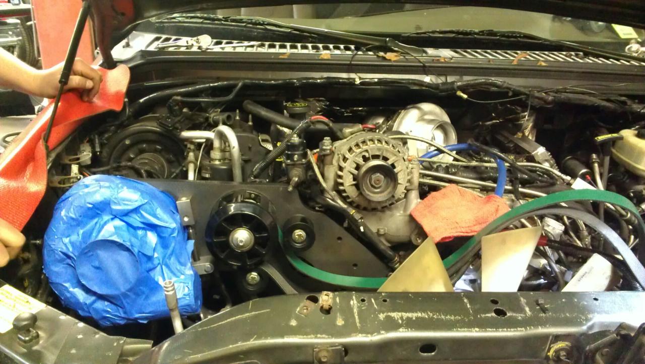

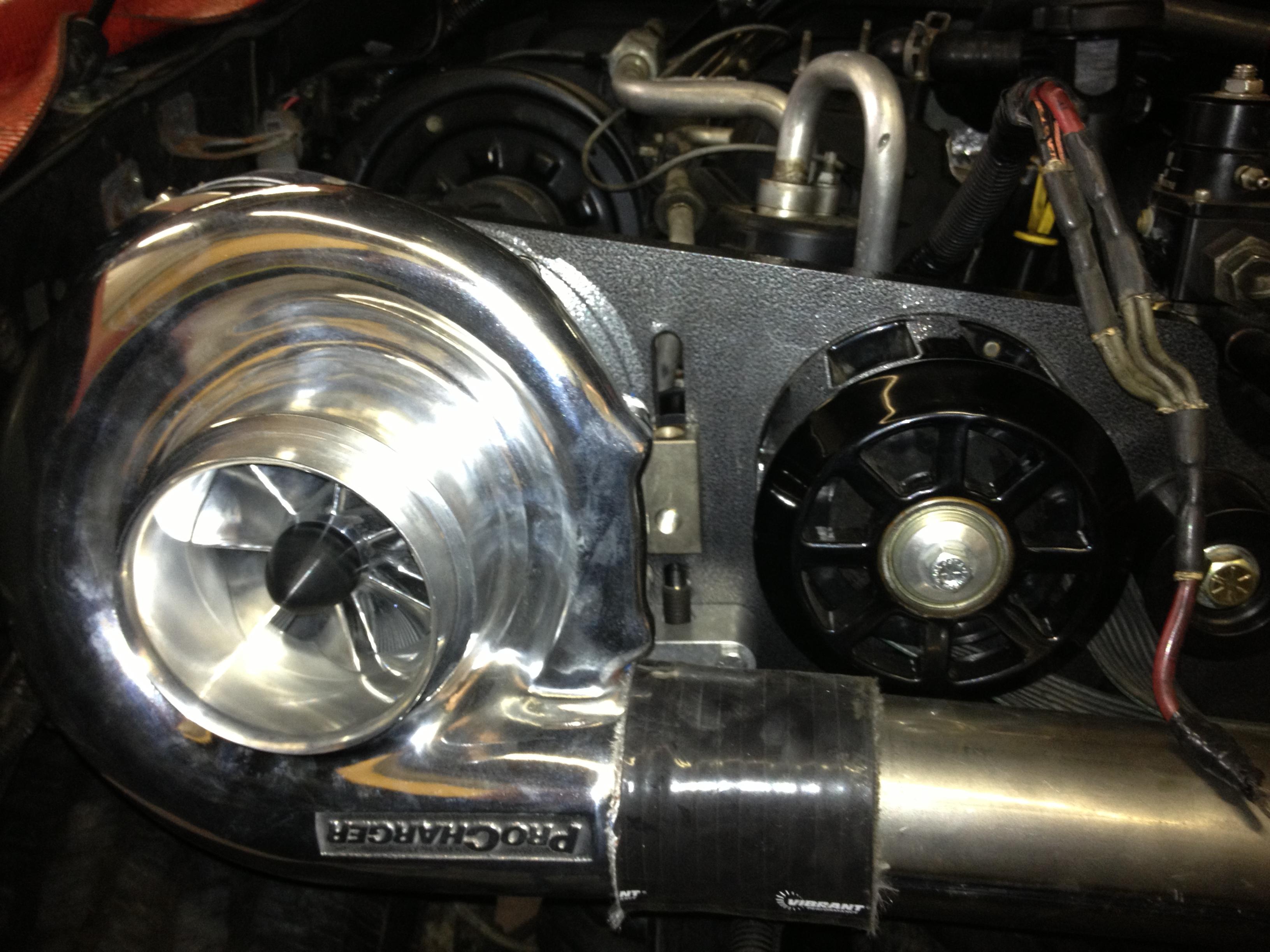

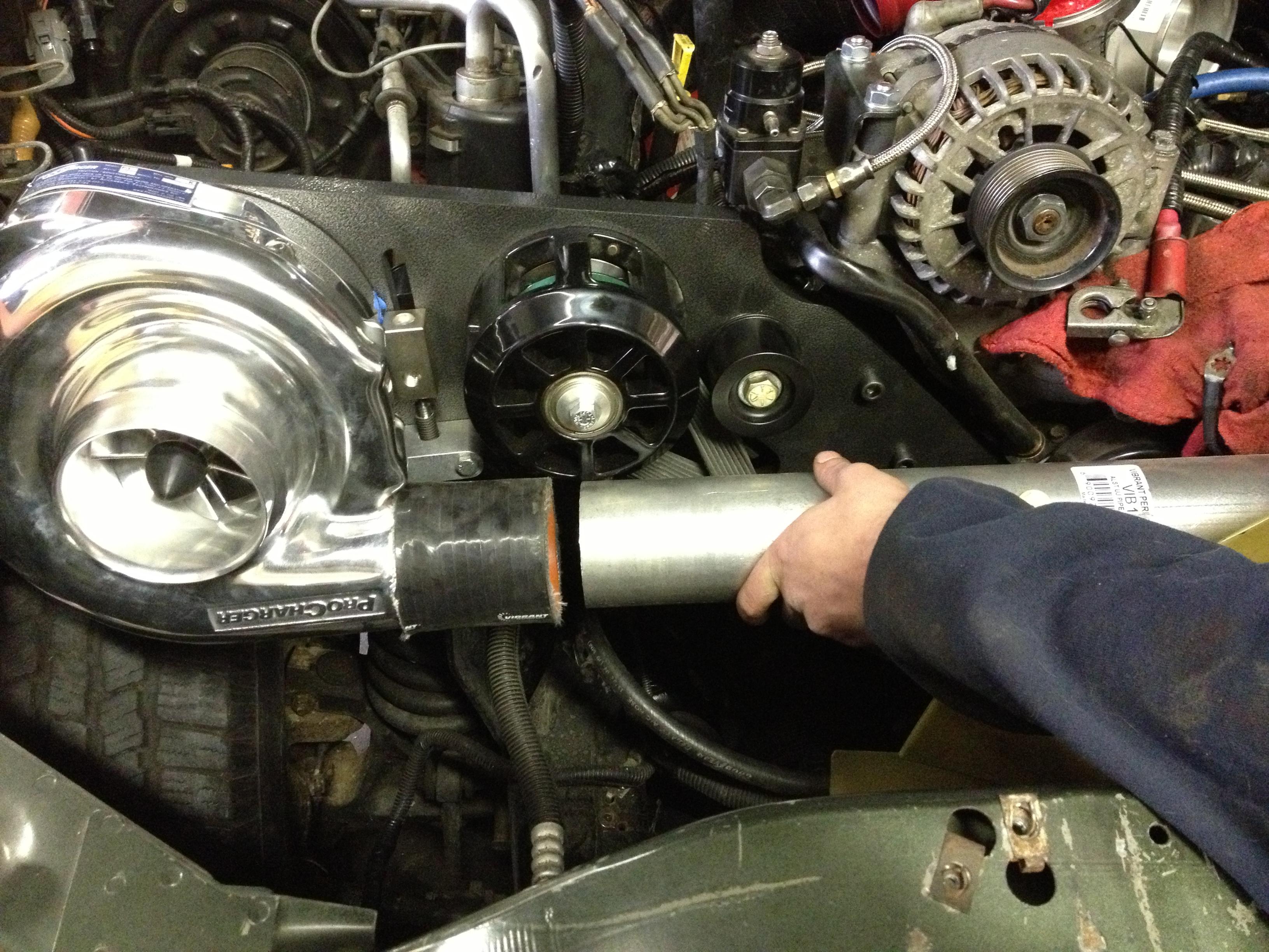

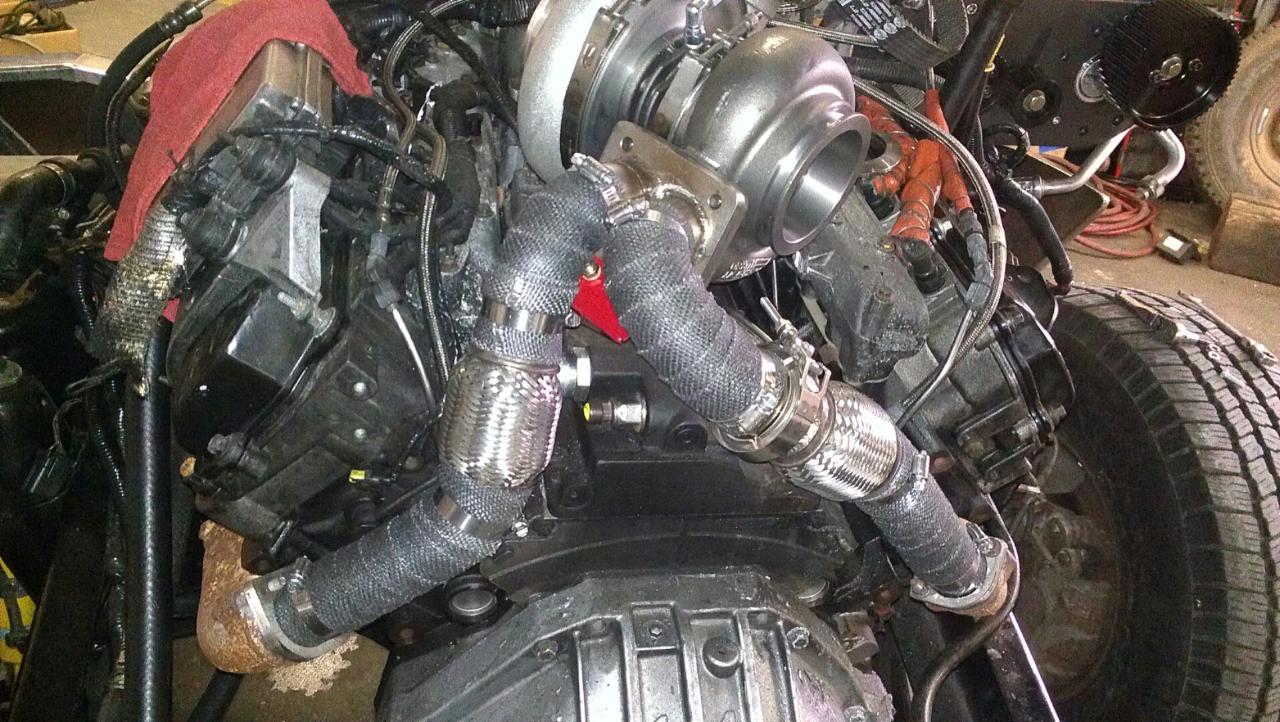

Well, slowly making progress. Had to do a bunch of fabbing to make this all work. Fred and James are a couple of awesome guys. Got some pics of the install and what is and isn't included with the kit. The kit comes with the Turbo, Procharger, Procharger mount, up-pipes/turbo mount, Belt, Crossover pipe from PC to Charger(we won't be using this pipe. What it didn't come with- Any other piping, oil feed line, oil drain tube, mounting bolts and gasket for turbo, boot for PC pipe to turbo. Here are some pics so far, I'll be happy to answer any questions anyone has, by PM's so nobody will get butt hurt. 062.JPG
Some test fitting, down pipe built.

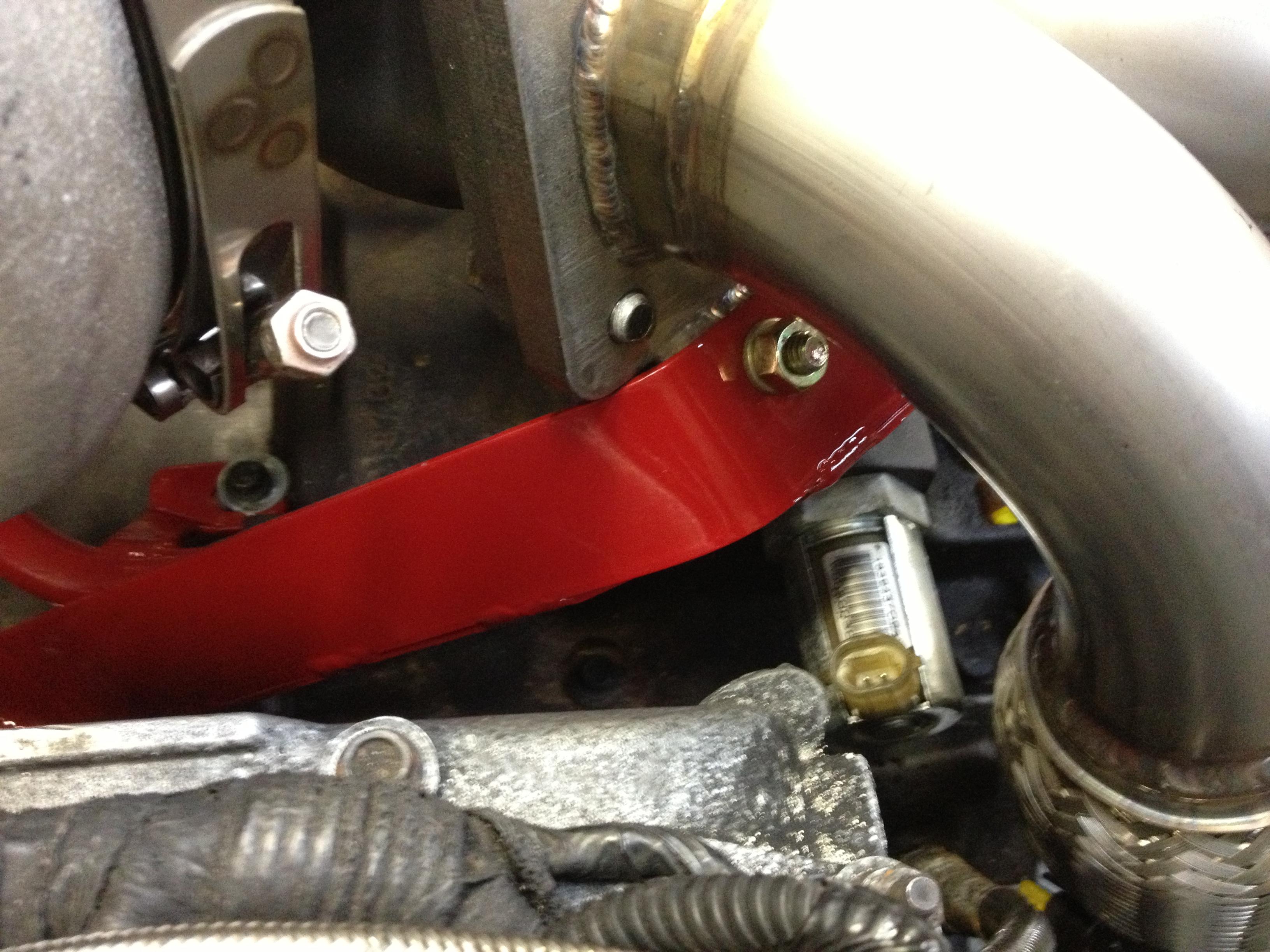

The bracket on the up-pipes/turbo mount had to be replaced because it didn't bolt up to existing holes in valley, besides having it bolted at each end allows access to the ipr the new bracket also gave clearance from the bellows to the IPR. This is the crossover pipe we're not using.041.jpg

Looks good man! So really, for a guy who isnt' changing the charger and only adding the procharger kit....all they really would need then is the boot for the procharger pipe to air inlet of the turbo....right?

Holy hell...You should use that cross over pipe...could probably drop 400*F in temps with that much length...
I'd love to have done one of these Prochargers a few years ago...
Good Luck! Looks great!
HiVoltage
67
Strokin, my truck has been through so many transformations
I honestly can't answer that. It might have got changed when
the compounds went in.
