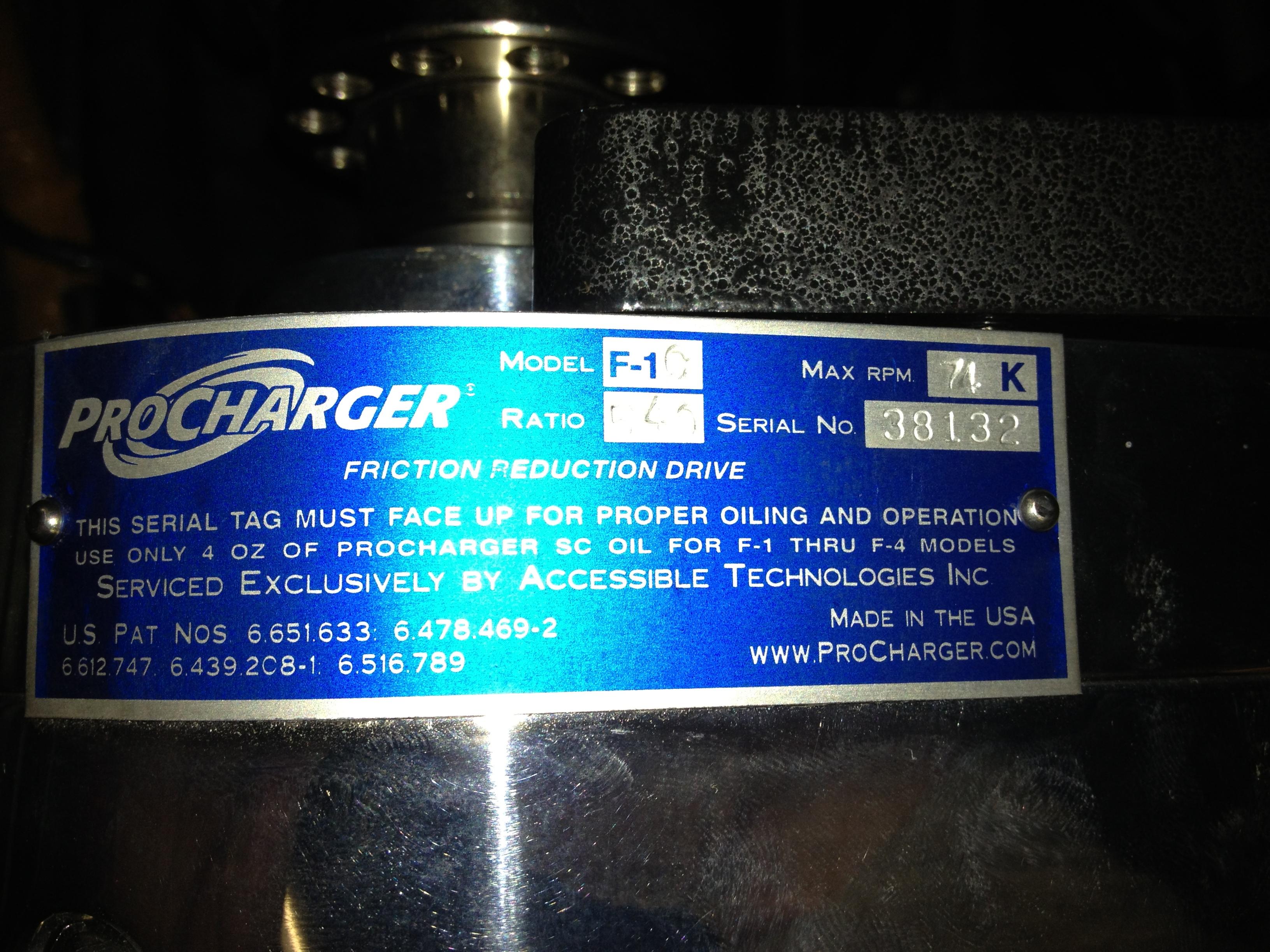

F1c

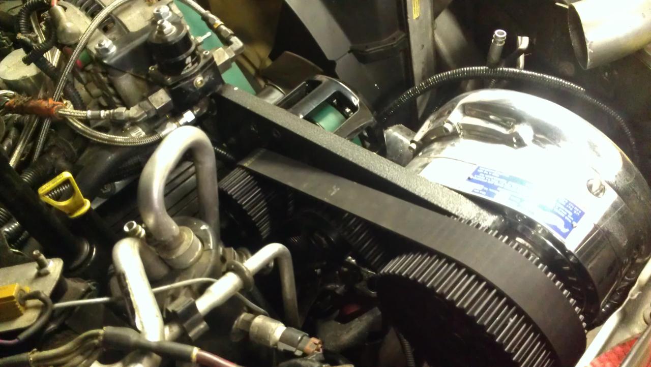

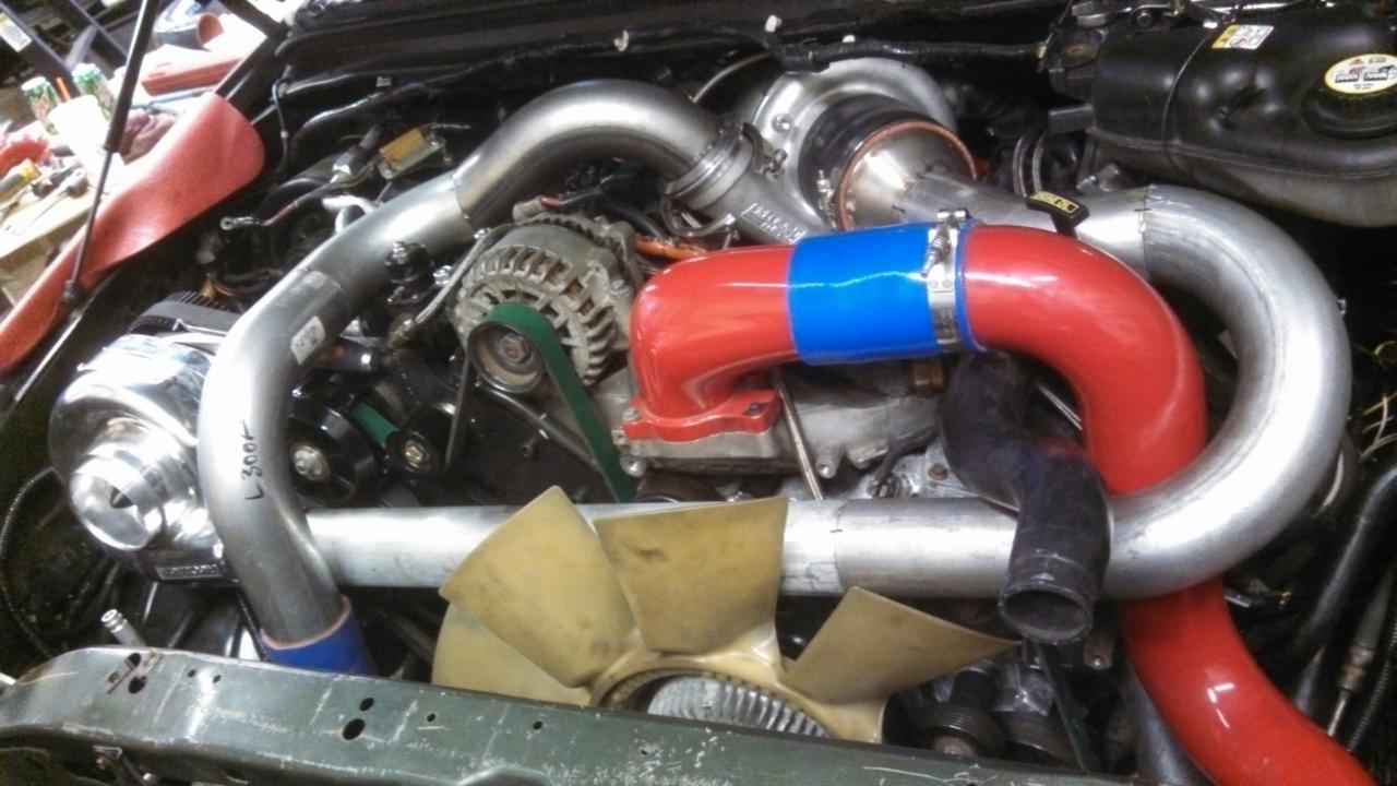

that is mighty pretty.... makes me wonder if i could mount one upside down on the drivers side... i say upside down so I could put it on the driver side but it wild still spin the right direction

You can get them in reverse and standard rotation for that reason...

Ive dealt with plenty of supercharged VR6 VWs in my day, the cogged pulley/belt setup significantly increased reliability and got rid of all belt slip on those setups, they were all vortech units not procharger.
If its done right i see no issues with reliability.

I had problems with the teeth getting ripped off the cog belts. That part is a easy fix. broke a serp belt once. That isnt a simple fix ether. Takes more that simple tools to fix. That part sucks
