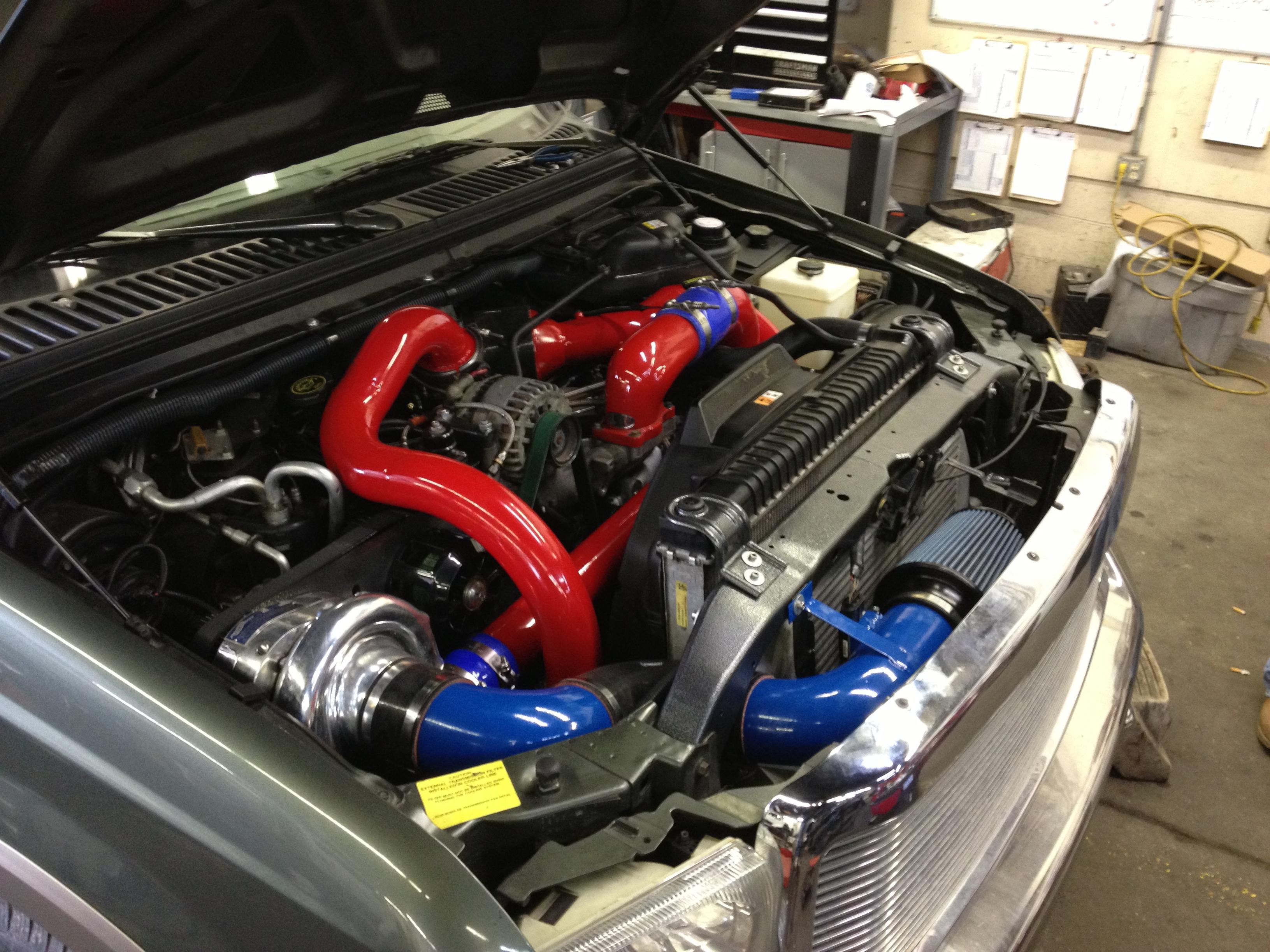

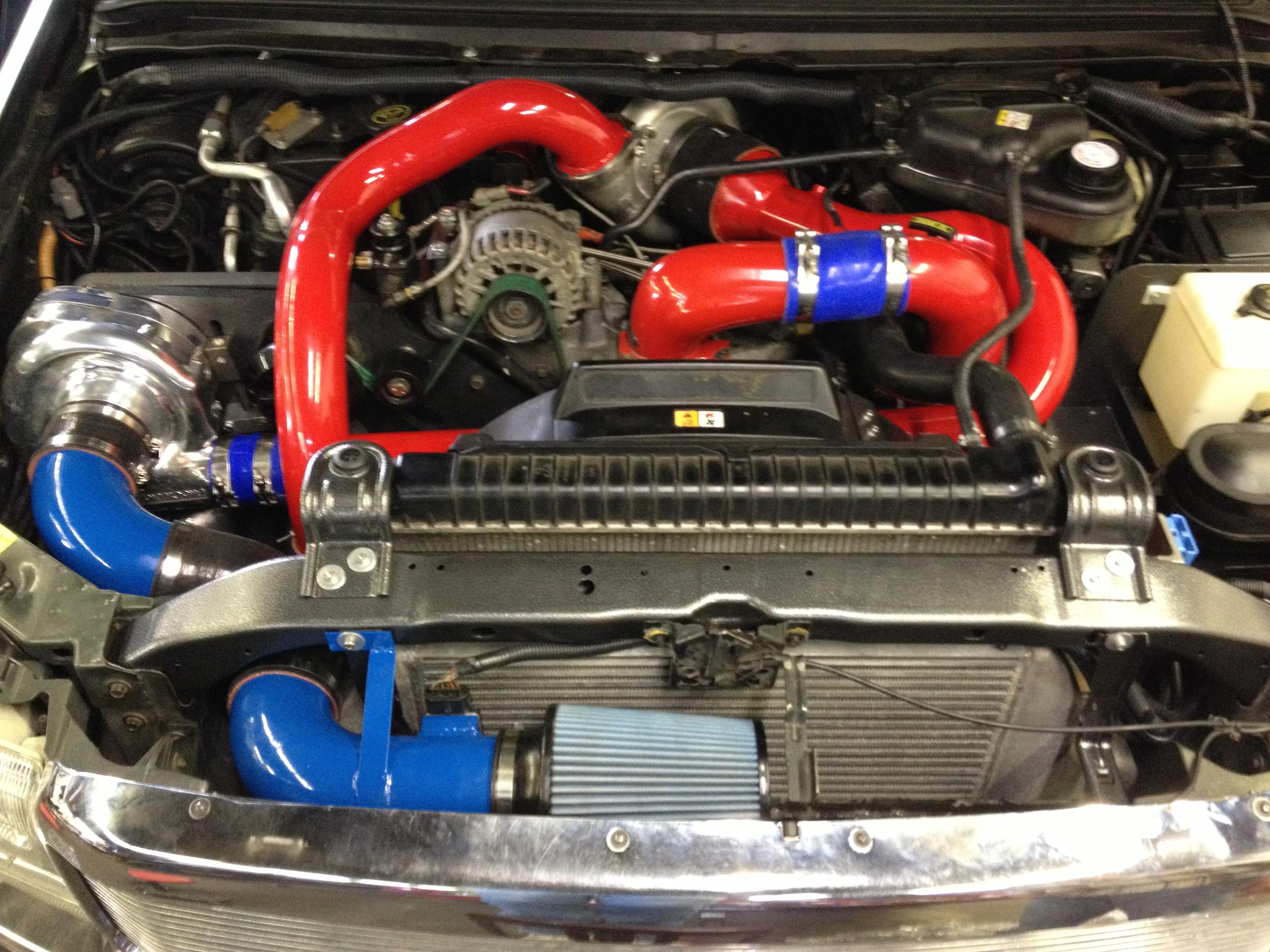

Testing and videos to follow.

Sweet looking set up. Can't wait to get another 6.0, gonna either go big single or empty the bank account and go big single and procharger. How well would F1 procharger and 475 or 480 match up?
HiVoltage
67
Sick. where did you order the kit?

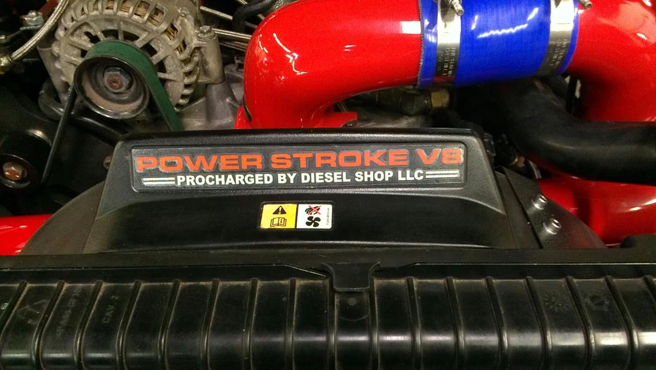

Got the "Kit" from Empire. Thedieselshopllc are the ones who did all the fabbing to make the "Kit" work. Basically this kit came with the F1c,mounting bracket, up-pipes, PT7175 "GT42 STYLE" turbo, new serpentine belt. All the piping was done by thedieselshop, along with many other modifications to make everything work. That's why there's a new Powerstroke badge on the shroud047.JPG
