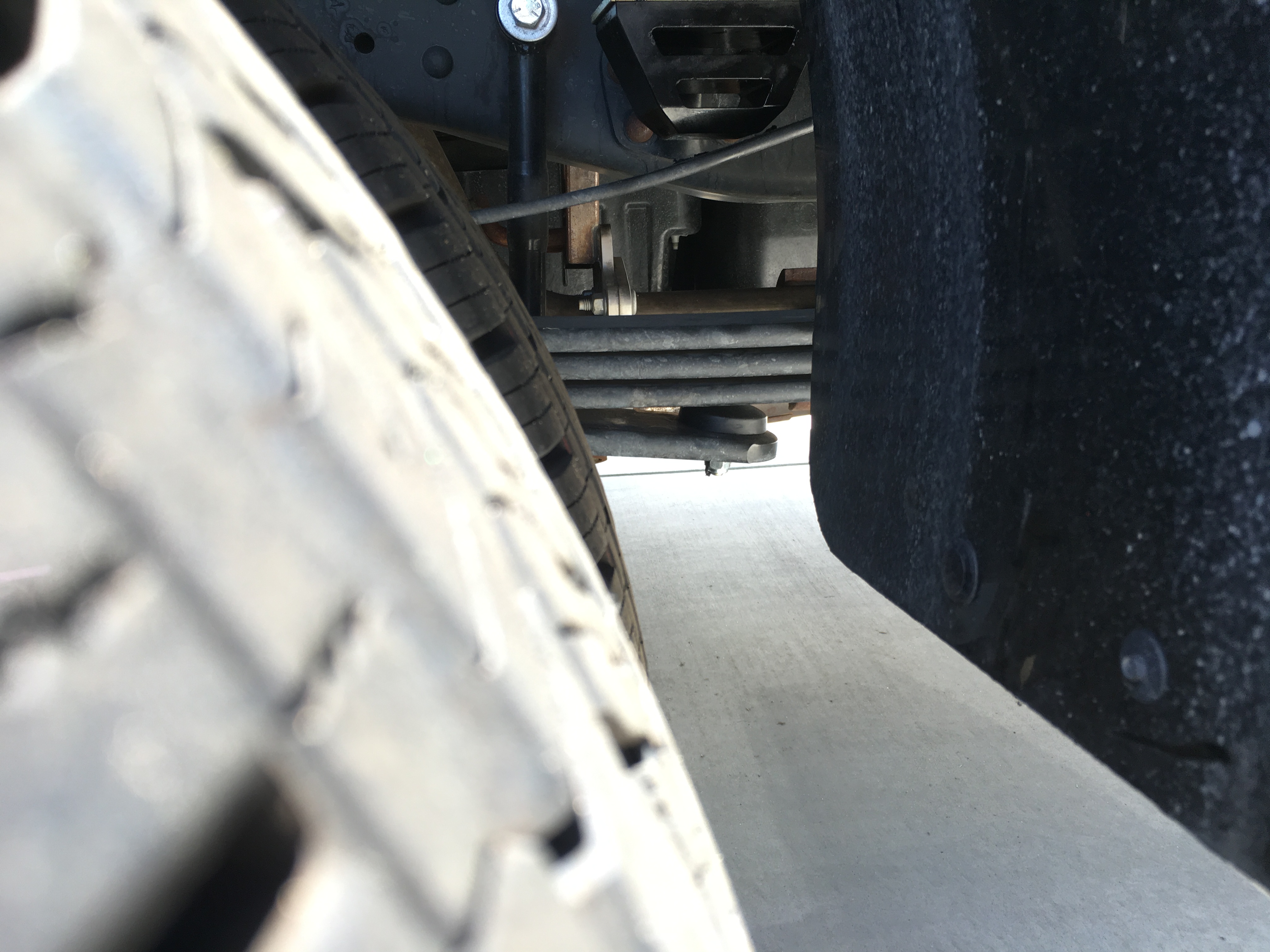

With the 16 F350 with a 14000 GVWR I thought it would be fine, well I was wrong. I put air bags on the truck also but I could not find a psi that made the truck happy. I did notice that with no weight and no air that the truck sat almost 4" above the upper overload. The 450 it was touching all the time. So thinking lets try making the overload touch all the time.
So I bought 2 sets of each of the following:
Energy Suspension #9.9109G and 9.9102G. Once number is for the upper overload and the other is for the bottom. This will make both overloads touch all the time. Here is what they look like.
Will give it a try. If I like it then I will most likely either have the upper overload re-arched or just buy a bigger spacer for between the overload the main spring pack to space it up more to almost touch all the time.
