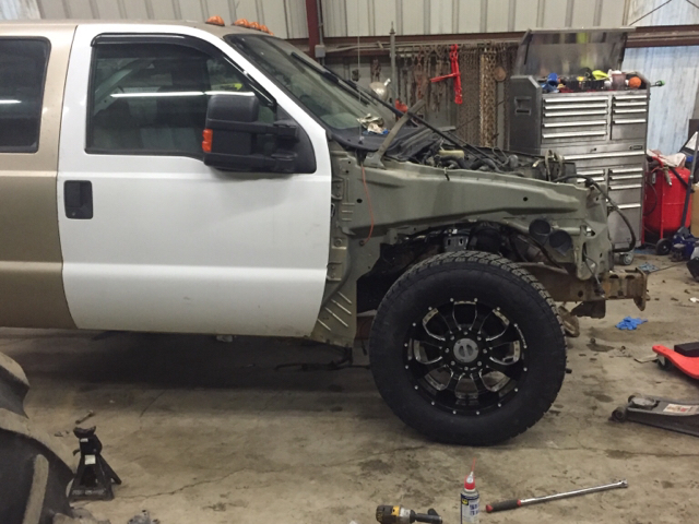

ImageUploadedByTapatalk1458008831.575599.jpgImageUploadedByTapatalk1458008843.498345.jpg
Air bags installed
ken6881
Oct 8, 2012
429
Baby came almost a month early at a stand still at the moment. Running accuair e level for air management.

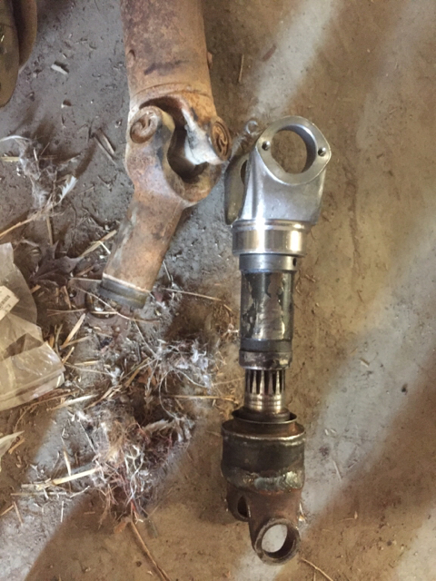

Still waiting on the machine shop. For bottom end. Working on dash swap and fitting trans to floor board. Made my short drive line to go from 1610 u joint on trans to 1480 on transfercase. Had to spend 4 hours on a lathe to do it because no one makes the parts to do it. T

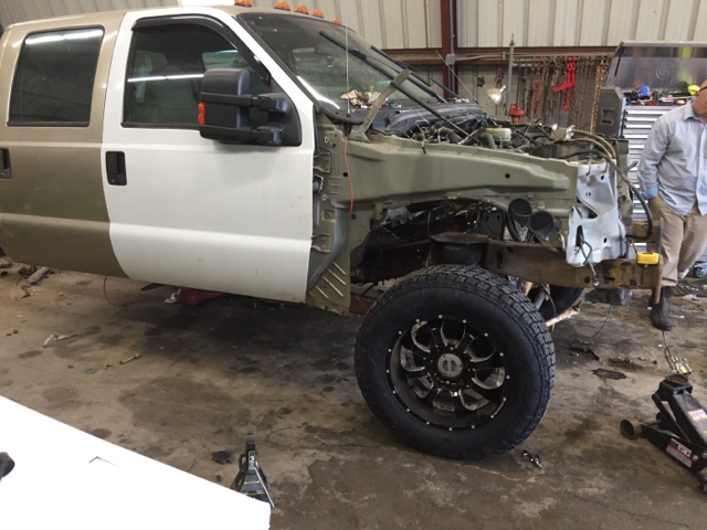

Got the old dash out and the wiring stripped from it along with a bunch of crap the previous owner had wired up in he cab best i can tell is he had xm radio, satellite internet, strobe lights under the dash.
ken6881
Oct 8, 2012
429
Bought a new house and the new baby took a lot of time but I did drive it to the new house. Need to finish the exhaust and air ride sensors, wiring for gauges, and lights. Paint and interior work.
