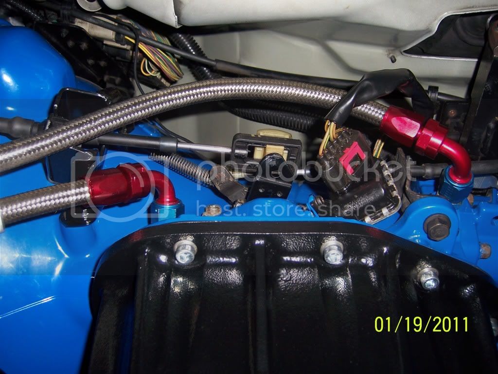

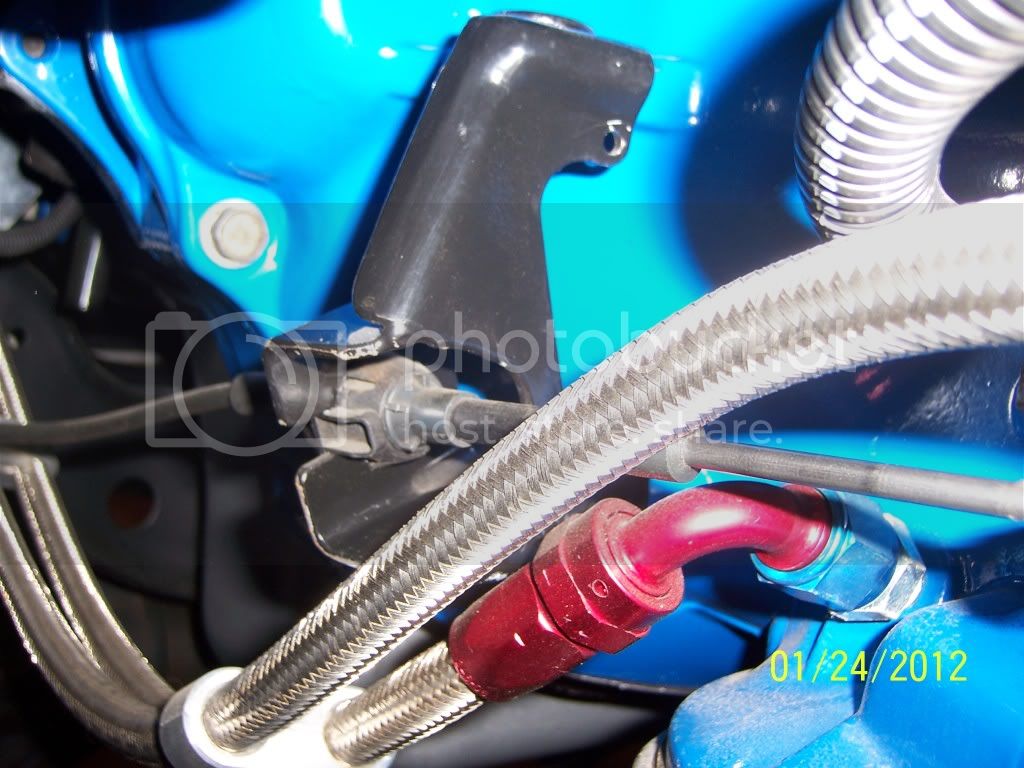

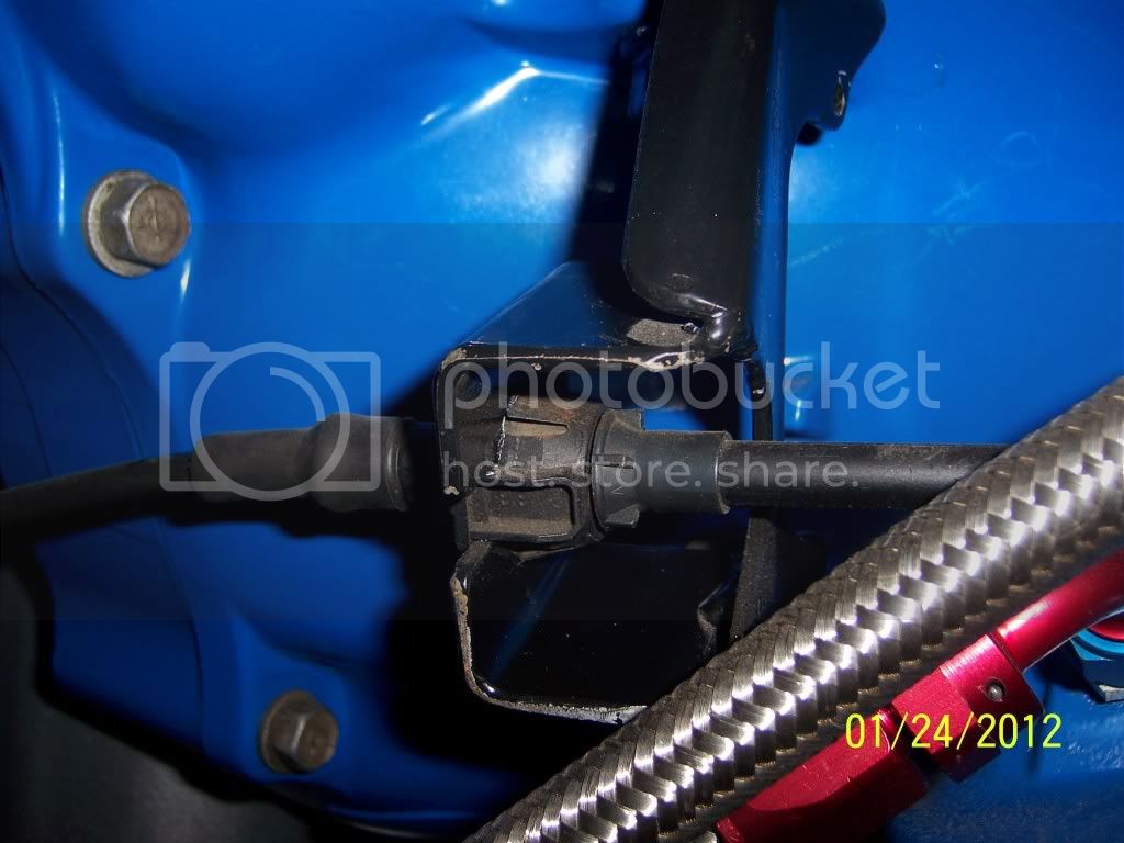

What I did was take the dodge mount that bolts to the trans and used that as the base, then took a piece of square tubing and machined it to snap the ford cable into. the tubing was welded to the dodge mount once I had it fit and spaced correctly. Here is a pic. not a real good view but you can kind of see it. If its not clear I'll see if I can get a better view of it for you

Thank you! Thats definitely a huge help! If you could possibly get another angle or two for a picture Id appreciate it!

I took a couple more pics for you, not the best views but hopefully you get the idea
Thank you for taking those! thats a huge help!

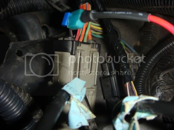

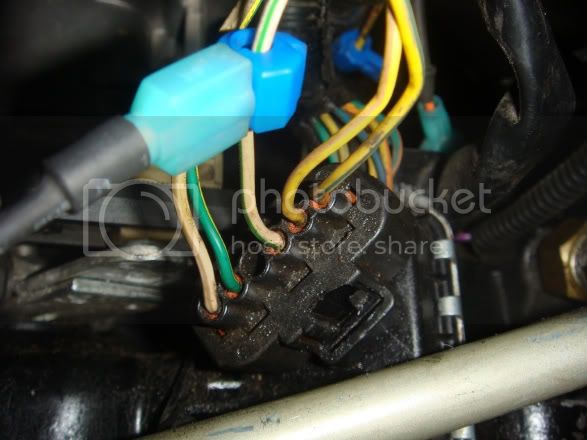

Sorry I hit a big detour when I walked in the door last night so I will shoot some tonight. But here is a write up I did on the reverse lights FYI. hopefully it will help:
...............On the 48RE there is a 6 port plug on the lower drivers side, first pic, that will provide the signal wire for making them work. I T-taped into the Tan/Green tracer wire and ran it to a relay in the engine compartement.
The other necessary wire is on the Ford harness. By following the rear harness from the back of the truck into the engine compartment one will find two plugs, one black and one gray. On the gray 12 port plug, one will find a Black/Pink tracer wire, that is the feed wire. See second pic..........
EDIT: I fused the 12V link to the battery with a 7.5A fuse.....

Thats definitely a help too thanks!
