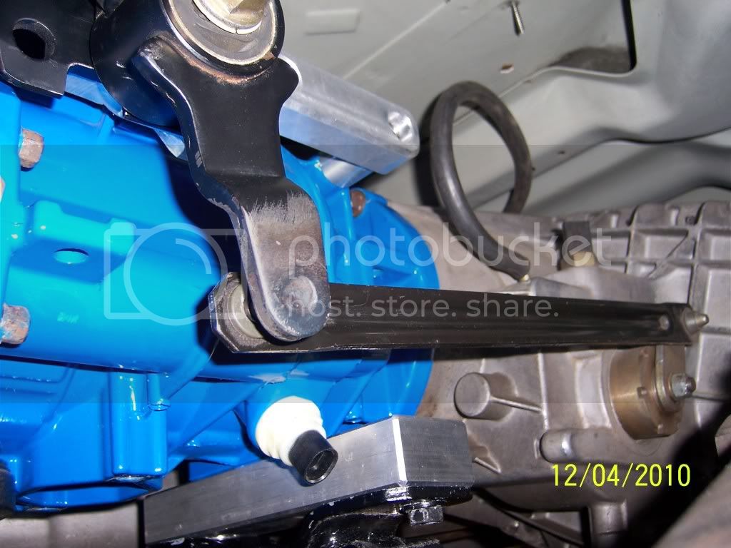

Ok one more question, what did you guys do for a tranny crossmember? Did you just modify the stock one?

I used the ford crossmember, moved it forward 1 set of holes on the frame. I had to slot the holes in it to use the dodge rubber mount. I made an aluminim spacer (I think 1 1/4" thick) in place of the one that bolts to the trans. This is the best pic I could find of it Matt, hope it helps

Yeah that definitely helps! I was hoping I could get away with moving it that one set of holes forward and modifying it a little. Thanks again for the pictures and help I really appreciate it!

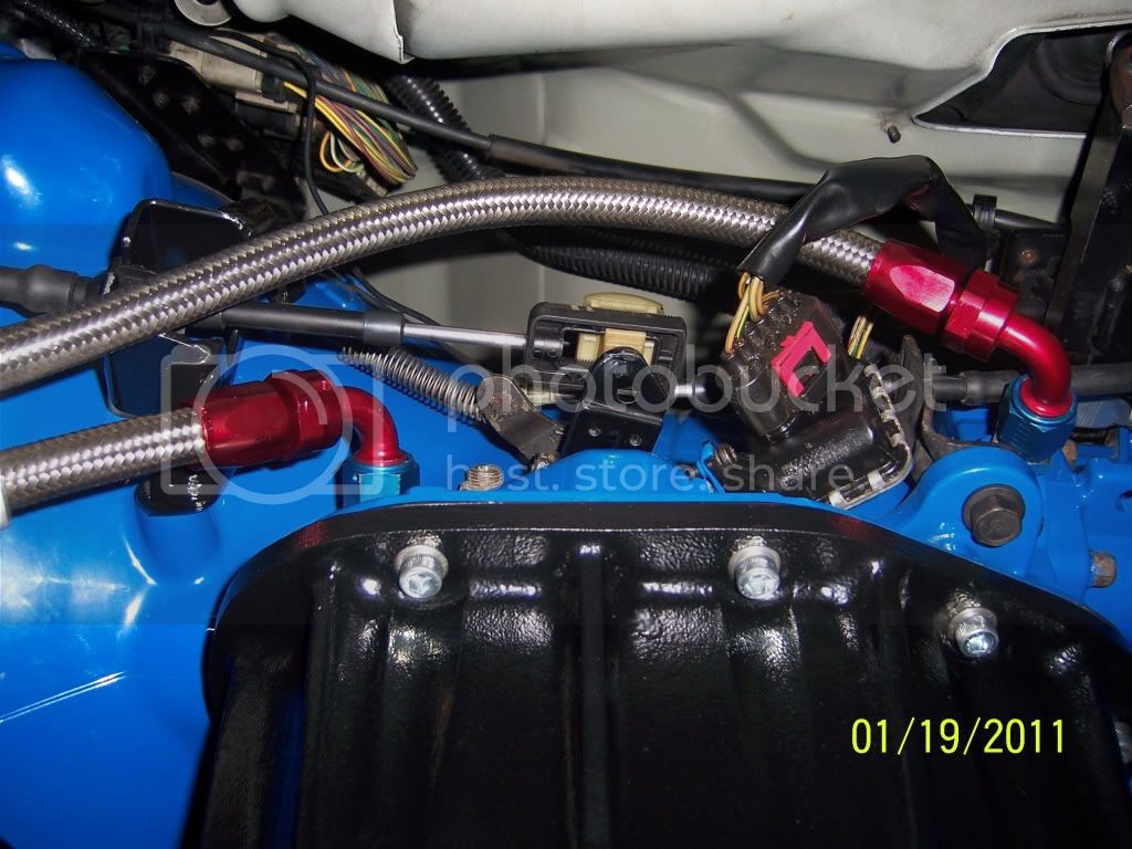

What I did was take the dodge mount that bolts to the trans and used that as the base, then took a piece of square tubing and machined it to snap the ford cable into. the tubing was welded to the dodge mount once I had it fit and spaced correctly. Here is a pic. not a real good view but you can kind of see it. If its not clear I'll see if I can get a better view of it for you
Hey I got one last question for you, What size fittings did you use to go into the trans for the cooler lines and also what size are the the anodized 90s that you used off those fittings for the cooler lines as well? Thats one of the last things I need to order.

The fittings into the trans are just a pipe thread, can't remember for sure but I think 3/8 NPT, and I just used 8 AN fittings and braided line. Aeroquip makes a nice push lock series of fittings and line that is a lot cheaper than the ones I used
