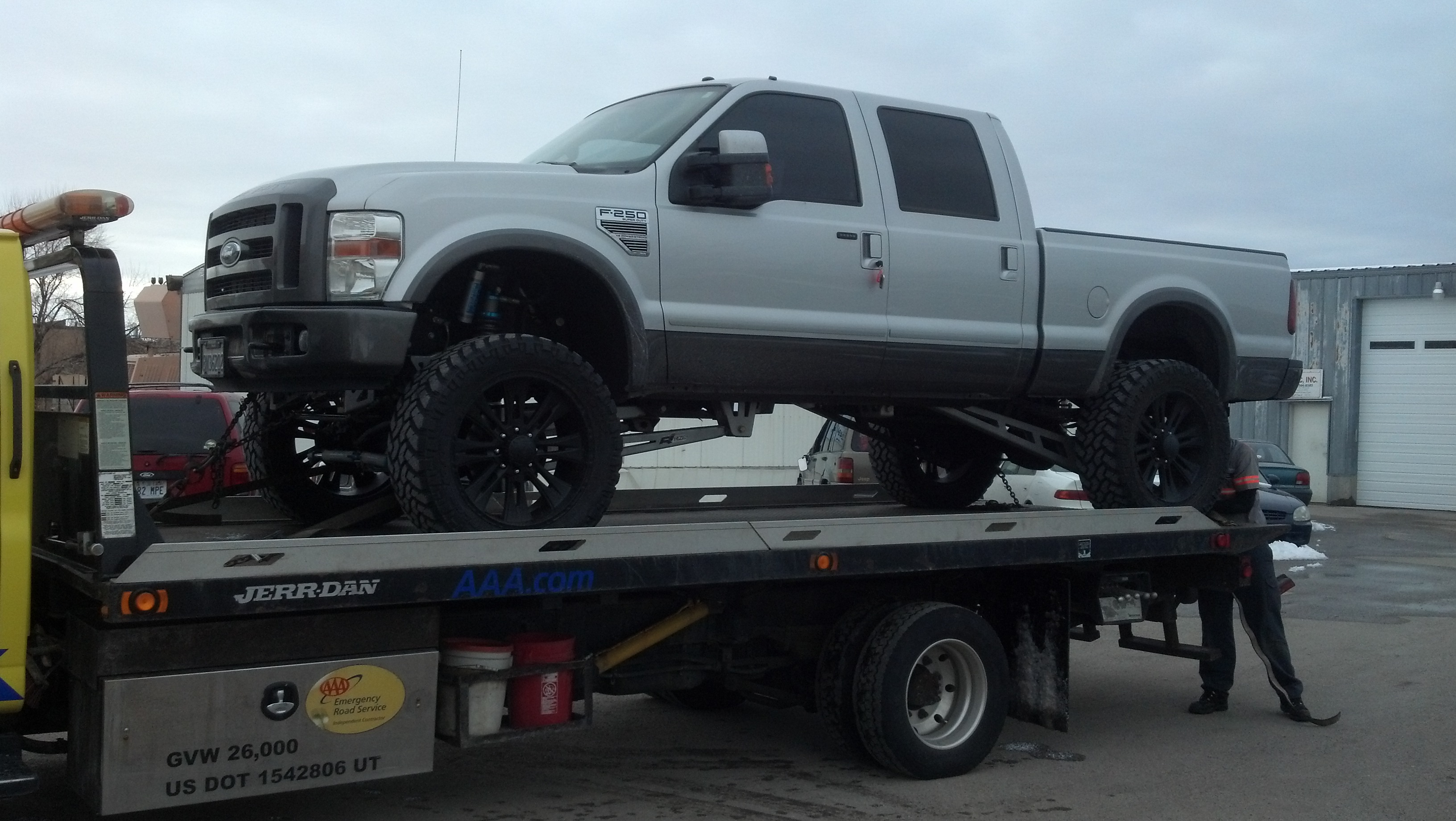

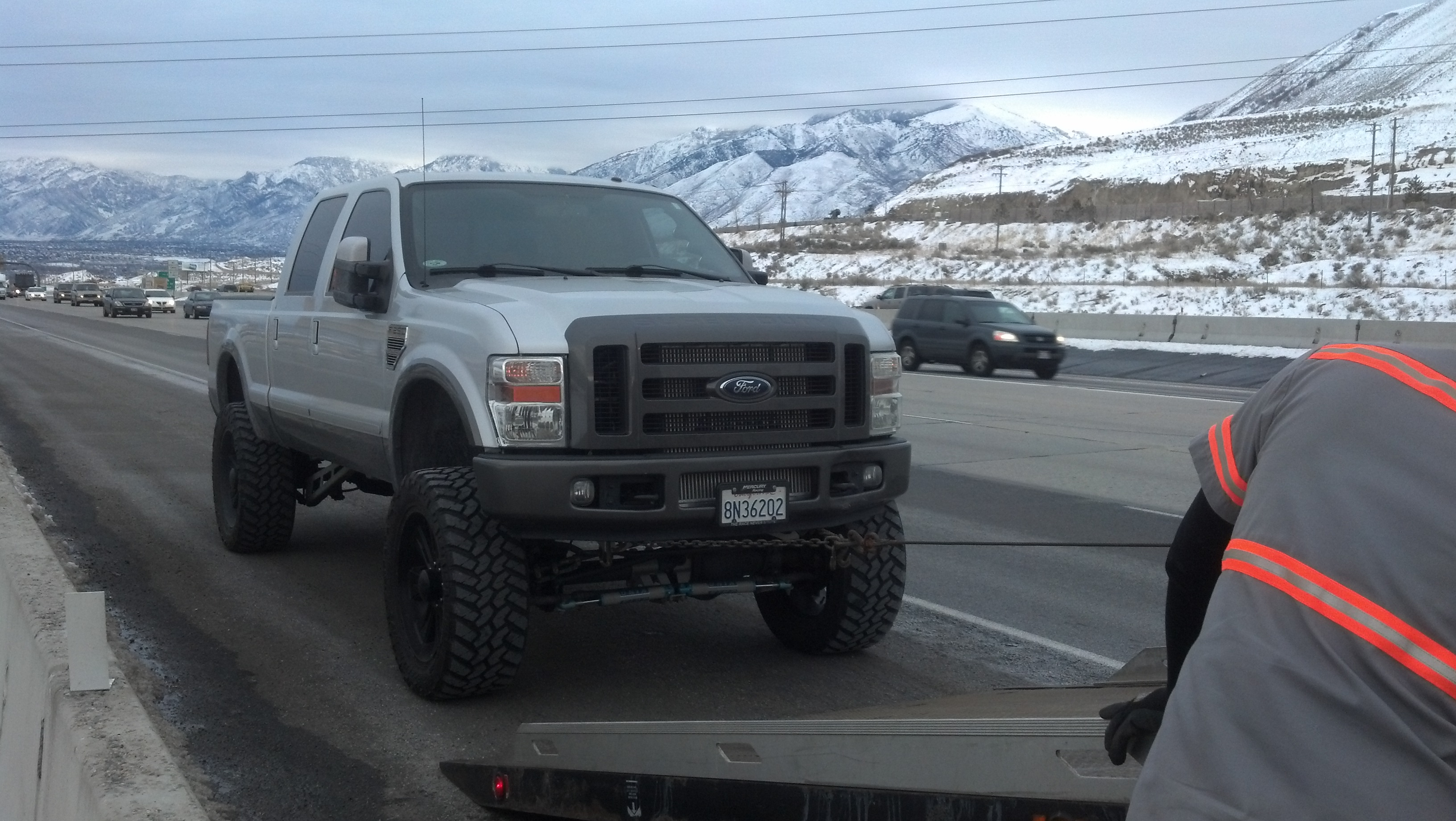

Truck didn't make it very far. I was on my way home back to California and it only made it 472 Miles before the Dragon Fire pump failed and left me and my wife stranded in Sandy, Utah. Not very happy about it. This build has been a nightmare for me.
Anyone have any feedback on the Dragaon Fire pump good or bad. I don't know what i'm going to do now.
No Fun to say the least!

Sorry to hear your luck I was sad when mike told.me the news. You do have a Damn good looking truck hope whatever you decided to do with it works out for you.

Not fun!
