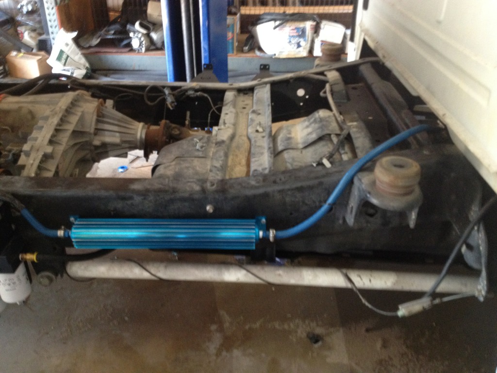

Super08Duty
1,489
College Station, TX
This is what I'm using, thanks to Ryan. Temps so far have stayed reasonable. Cooler definitely works, don't put your hand on it after driving for a while, because its using those heat ribs.

That's how I did my system. Sump to water separator to A-1000 to 2 micron filter to reg. connected to the regulator is the pump feed, the injector and pump return and obviously the return back to tank. Return has a cooler like shown above. Sump to regulator is all -10 and pump feed and return is -8. The injector return was -6.
