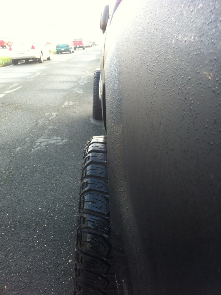

I have some 12 wides coming as well. Do you have a pic that shows how far they stick out pass the fender wells?

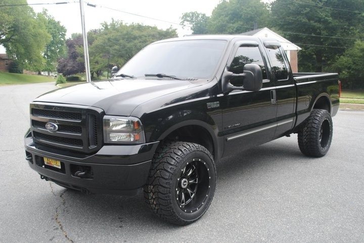

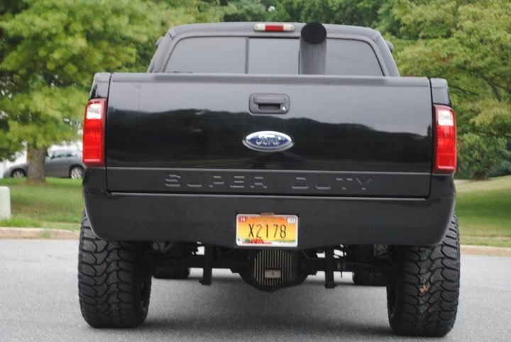

Seems like upinsmoke has you covered but here are some 20x10's... It was a tough decision between the 20x12's or 20x10's but I think I made the right choice.
Kinda posted some but not direct side shot. They stick out 3-4 inches past the fender with the offset I had
Truck looks sweet!! Def more tire options with a 10"wheel

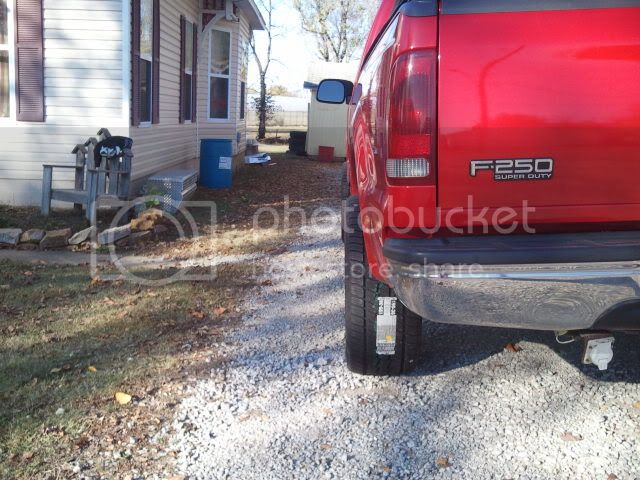

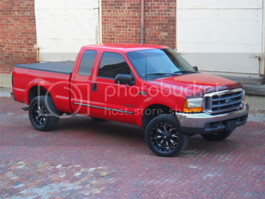

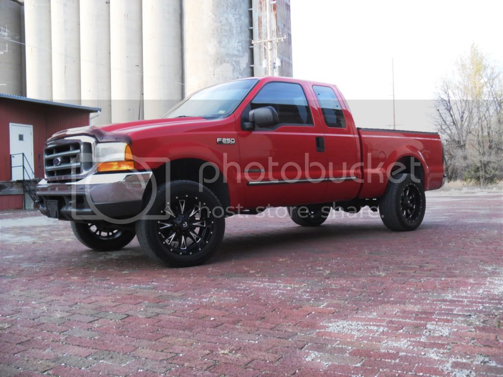

On my truck now, with 12 wides, the tires.dont really.stick out. Generally speaking Id.say my truck appears wide but.is.actually just slightly proud of the lip on the fender, right above the wheelwell. The 12 wides(throttles) are about an inch wider, which makes sense given the difference in offset. My old 16s are -25 offset, the new ones.are.-44. A net difference of about 20mm. Or an inch(25.4mm/inch). Im not underestimating your understanding of all this wheel lingo. Not at all. But I anticipate 2"of "stick out" once a tire is mounted on these.wheels.
Heres a.couple.of.my old.setup. As you'll see with a -25 offset, the ****.dont.stick out much even with a 16x12/37x13.5. Just slightly.
http://i1142.photobucket.com/albums/n618/titobandito78/Rearshot.jpg
http://i1142.photobucket.com/albums/n618/titobandito78/Frontshot.jpg
I know its irrelevant BUT Im just trying to help. It would.have helped.me.so.I.thought maybe you.could use it.
Dude that thing is beautiful. How bad do the tires rub at full lock? your not hitting the front fender at all? Also, were did you buy the role pan?
