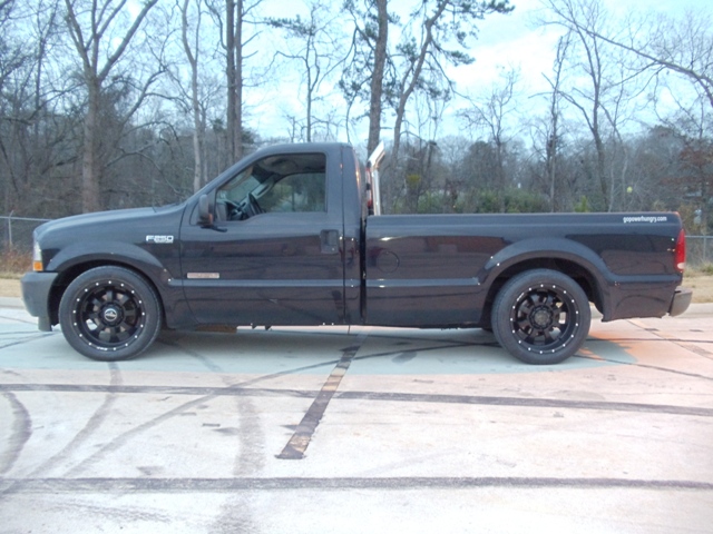

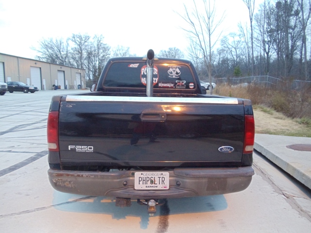

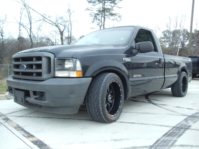

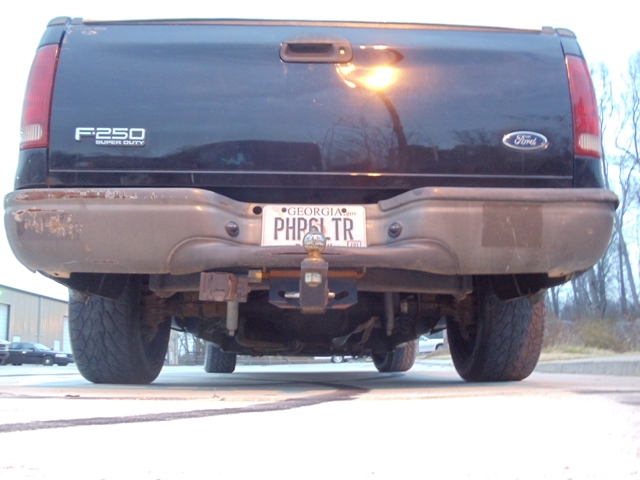

Okay, so here's where we're at so far. Got the bed back on and still need to make some height adjustments on the rear. However, I think it looks pretty good so far. We'll pull the bed back off this week, readjust the suspension (I think putting the longer rear shackle back in ought to do it) to level it out better, shim the axle for correct pinion angle, and then get the traction bars installed. Anyway, here's the pictures with the new wheels and the bed back in place. Enjoy!

please take that stack and smash it, does not do the truck justice at all. other than that, the truck looks great!!
Garrett
Trust me... I'm right there with you. I'm no fan of stacks and have stated as much in the past. However, given what we're using the truck for (lots of racing), we had to make a decision on how to handle the exhaust so that we weren't clouding out the timing guy at the dragstrip. They get a little fussy about that and I get sick of running the right lane all the time. :hammer: With the lowering kit, we no longer had the room to go over the axle with an exhaust. I could do it in front of the rear tire, but once we install the traction bars I may have another clearance problem. The stack was the only option that solved all the issues. I went with a simple 5" Aussie stack because it wasn't as gaudy (to me) as the larger stacks. I haven't settled on the height and may drop the stack 2-4 inches to give it a cleaner look. I'm certainly trying to achieve a certain look (with stance, wheels, and other coming modifications), but the stack is purely a functional aspect.

Just a different stack. A short Aussie or miter. It looks out of place for some reason now.

I say a black 6"-7" mitre cut, sitting right below the top of the cab... But if the chrome stack stays then it would look best lowered down some and possibly offset to the passenger side. Then again if we all wanted the same thing life would be boring lol and when your in a truck passing sports cars at 100mph who cares hahaha
