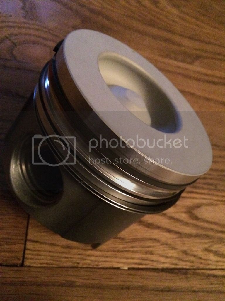

Got crank and bad piston out. Should be able to polish out scratches and put new bearings in. Call me stupid, I don't care

that can be done, but I would feel more comfortable having a machinist do it, but I know where your coming from. Did you have a piston made?

Need to ship it back to Swamp's so they can replicate it.
Machine shop will work on the crank.
