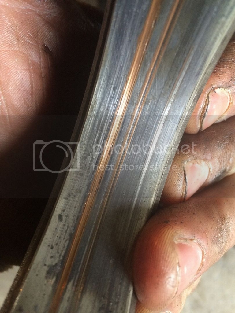

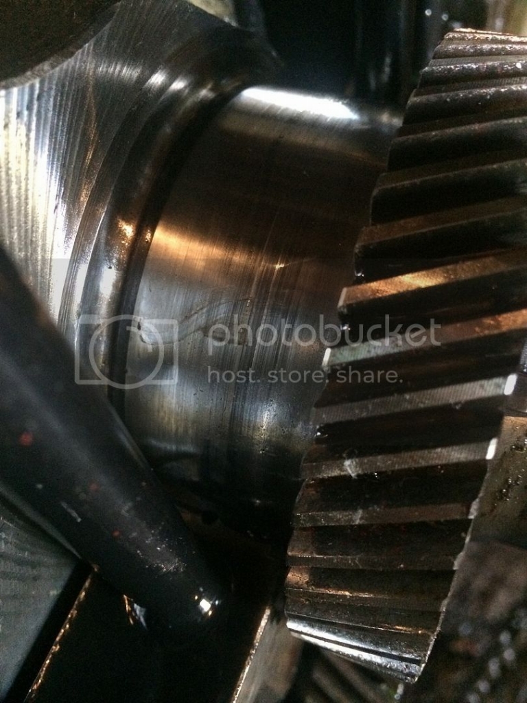

MOTHER TRUCKER!!!!!
Main bearing. So much for just putting back together. Throwing hands up. Don't know what to do.

Man that suck! Craigslist forged bottom end and replace them whenever they blow. As cheap and tough as they are and as easy to swap its not the worst idea.

Was thinking the same. Put a used engine in and if my engine could be disassembled, inspected, new bearings, piston, and crank could be polished out, assembled, that might be doable.
