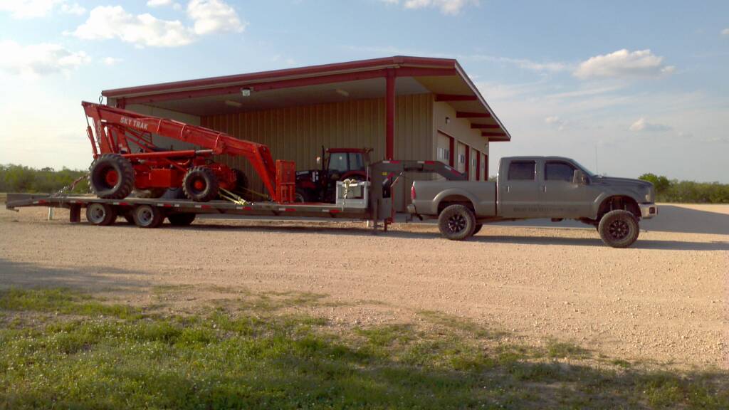

39k I don't have a weight ticket but that's what the scale said! If I stayed out of od and kept my speed at 55 I did good. 4.6mpg Houston Tx to Lander Wyoming.

how did you not get stopped or ticketed? LOL
why would he get ticketed? Hes actually legal. (provided proper weight distribution)

Not even close. GCWR for an OBS F-350 is 20,000lbs max, 18,500lbs if you have 3.55 gears.
Maryland DOT would have turned him every way but loose.
I thought DOT went off the axle, hitch and licensed ratings not the suggested rating the factory puts on the truck. If you go off of the GVWR rating you can't pull much of anything.
Gross combination weight rating (GCWR) means the value specified by the manufacturer as the loaded weight of a combination (articulated) motor vehicle. In the absence of a value specified by the manufacturer, GCWR will be determined by adding the GVWR of the power unit and the total weight of the towed unit and any load thereon.
