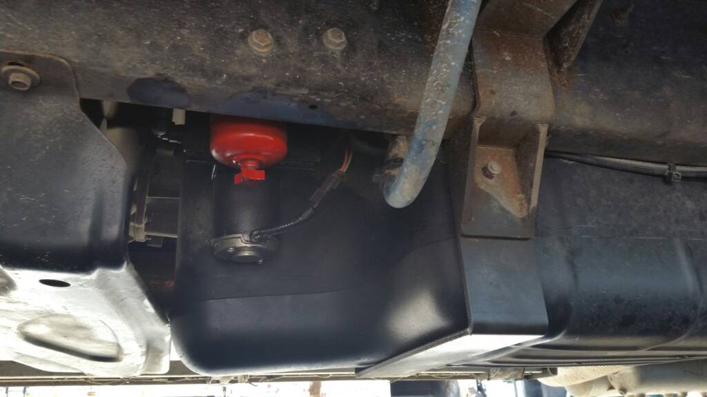

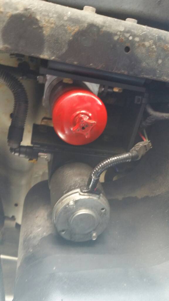

I remounted the pump so that it sits vertical, versus laying horizontal. This way it won't hit on the tank. I also rotated the end cap on the pump, 180 degrees so that the harness wouldn't rub against the tank. I doing this, I think I flipped the brushes around as pump was running wrong direction. I just repinned at the connector to resolve that. Disregard any fuel residue, I was pulling fuel out of the truck for another truck.
Sent from my SM-N910V using Tapatalk
Just a little update on this, I would advise NOT mounting the pump like this. Mine has went out with bout 20k miles, working with Dallas on fixing and will be figuring out a new location to keep it in the horizontal orientation.
dang. i wouldn't have thought that it would make a difference how it was mounted.. is there a specific reason that it should lay horizontal?
