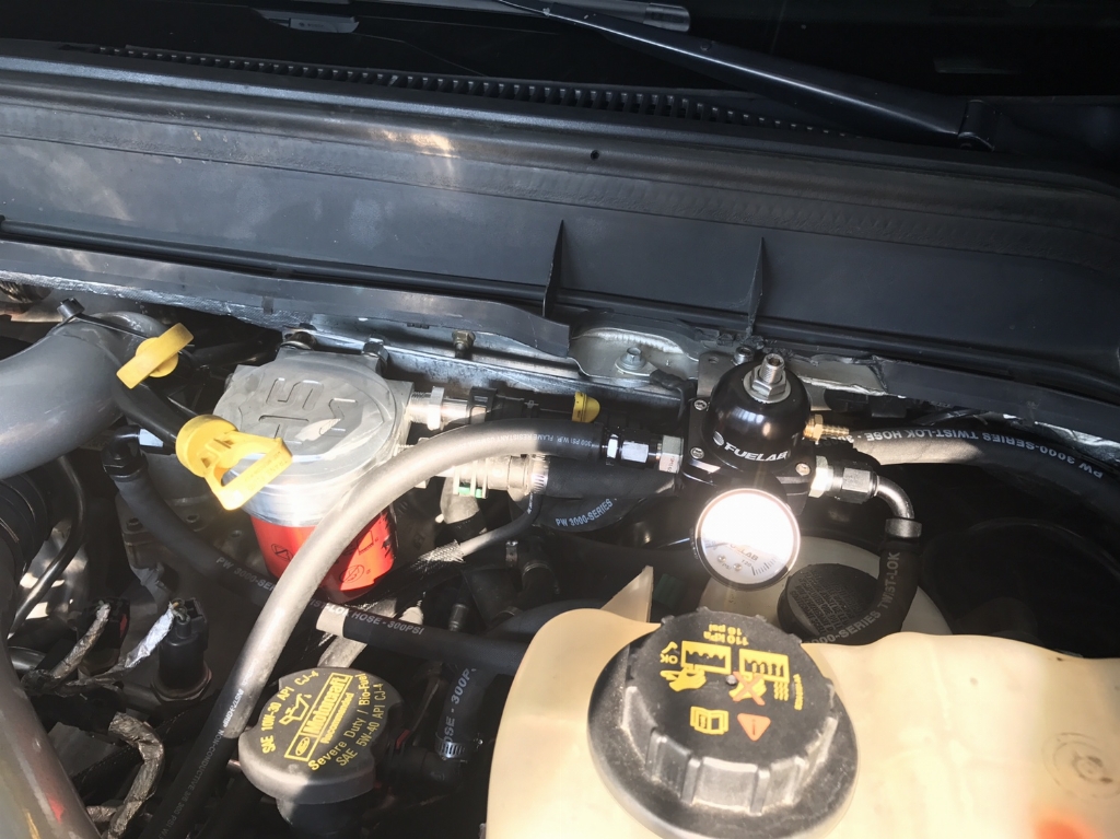

Install was a breeze. Had to fab up a custom mount for the filter and regulator due to having the Midwest piping. Big improvement in rail pressure stability and overall drive ability compared to the stock LPFP....

Any pics? I will be doing the same and have the MW pipes.
It's far from pretty, but it works! It's a piece of scrap aluminum c channel I found at my shop and I attached it to the two studs at the firewall. Attached the fuel filter to that and routed the hoses from there. I just bent the regulator mount bracket and bolted it to the top of the firewall more or less...

That's actually pretty clean. I had to do the same but mines a little different. Looks good to me.

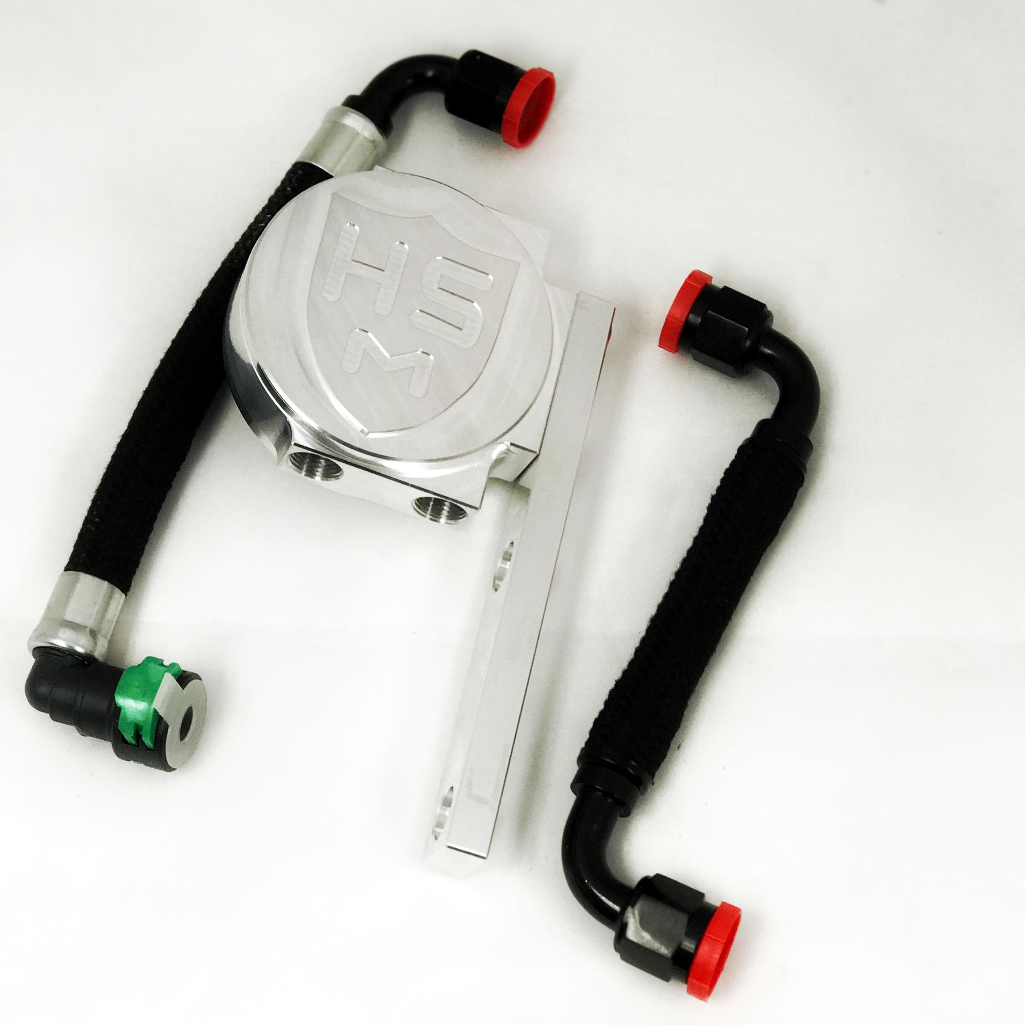

Here's what they look like.
Can one use this for a stock motor? I'm still trying to get rid of that annoying whine at idle. I'm almost 100% sure it's the quick connects at the filter.
This kit seems that it removes one of the quick connects?

yep i ran one on mine from the get go. pretty sure i had the 2nd kit they made . it's ***king gold.

I still get the whine with the new system. Perks of the truck I suppose?
