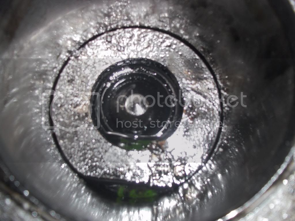

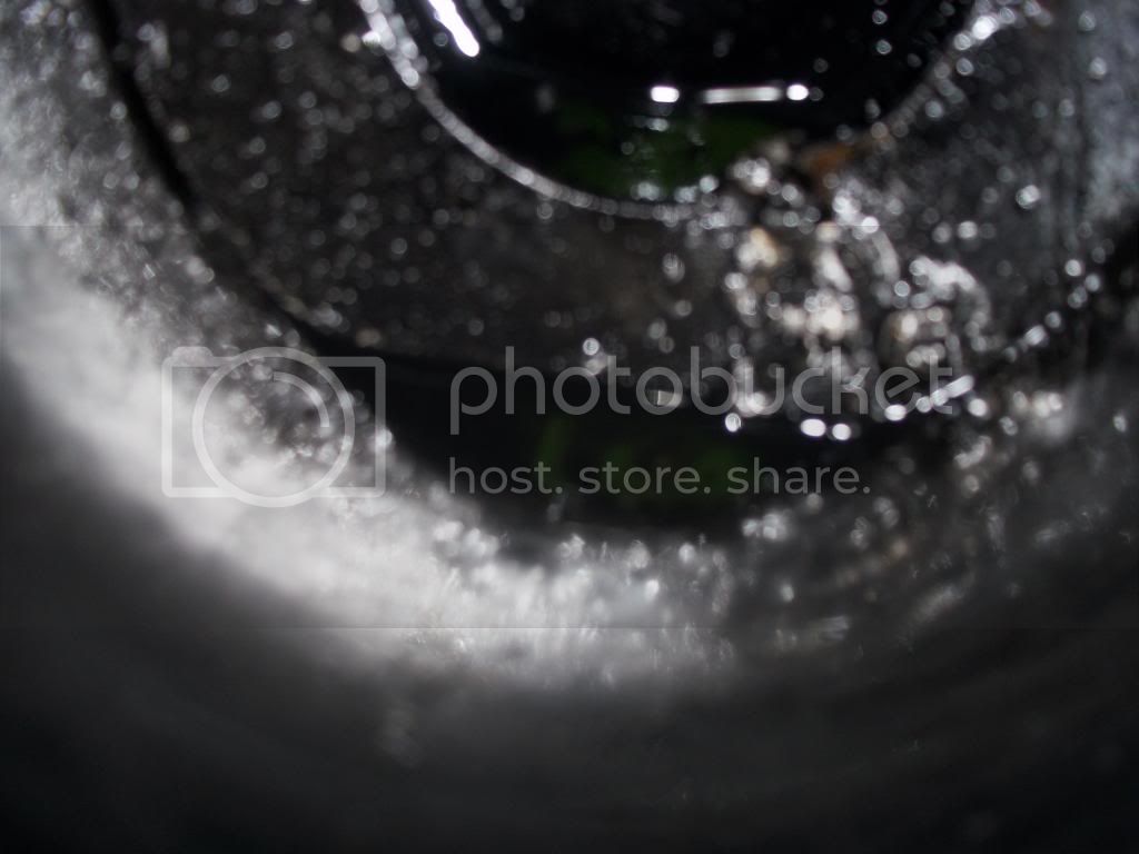

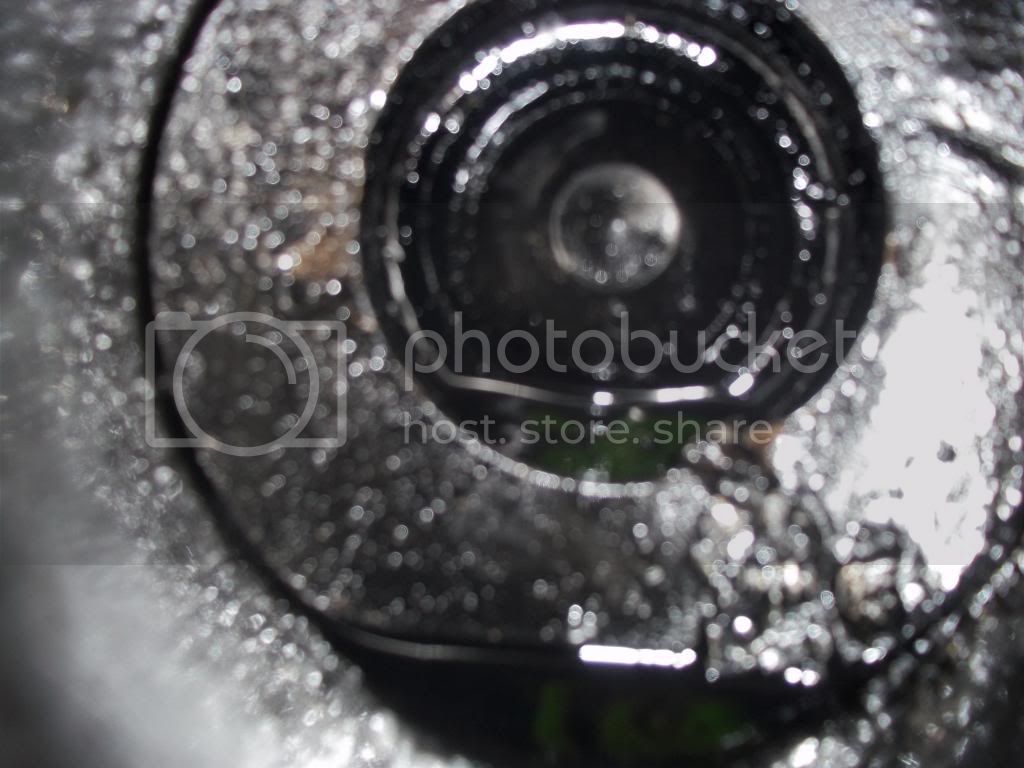

well guys, finally figured out the problem, about a month and a half ago when i was changing fuel lines in the fuel lines on the fuel bowl, i knocked a small hose clamp into the intake plenum, but i soon found another small hose clamp at the bottom of the valley(thinking that was the one i knocked off) ran fine for the month untill i gunned it and it ended up getting CRUNCHED into the piston, now i dont know if its any good, any ideas?

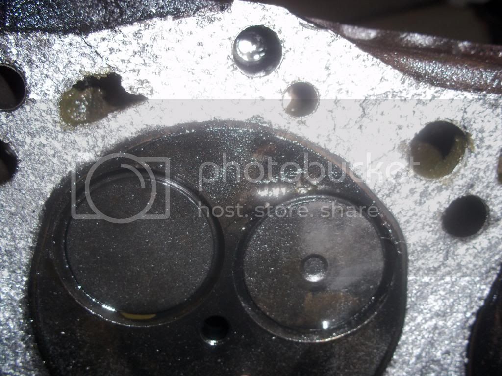

The pictures are fuzzy. But it looks like your going to need a piston and possibly a head.
I have heads to sell if you need them?? In reality if the head isn't. Gouged to bad or cracked? I would smooth out the sharp edges and reuse the head. Piston replacement is a must.

last pic shows the puncture the hose clamp made on the head, look bad enough for a new one ?
