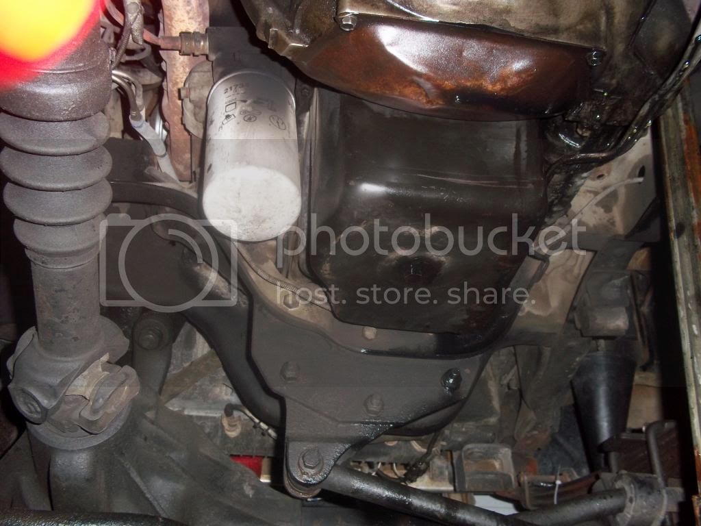

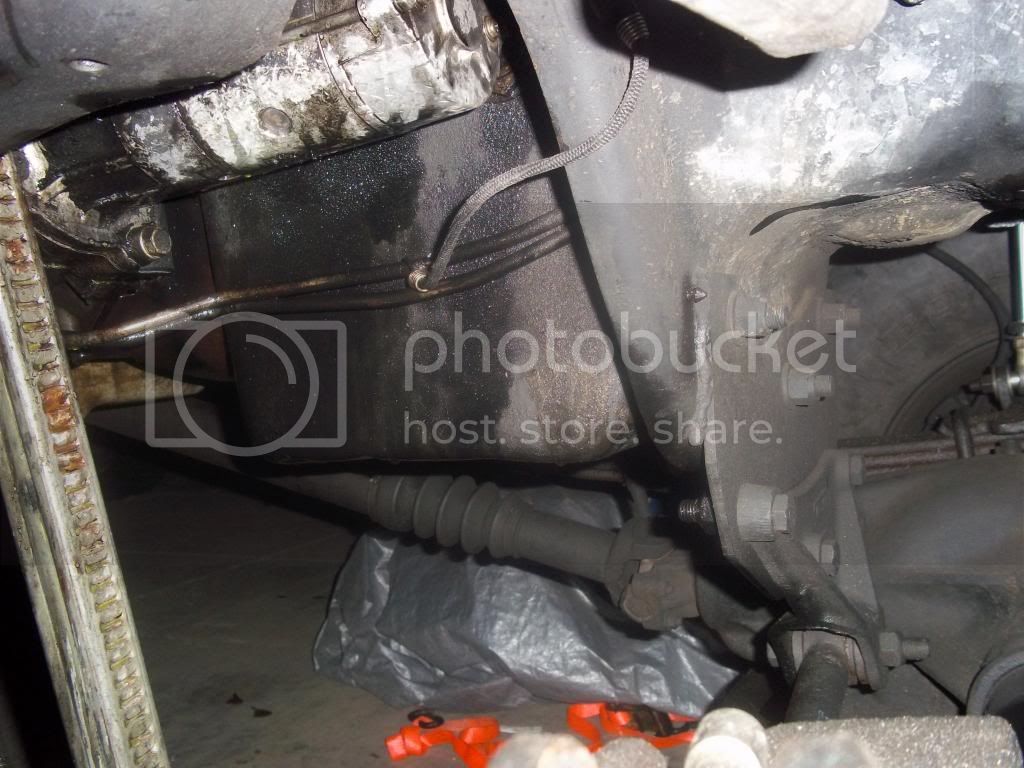

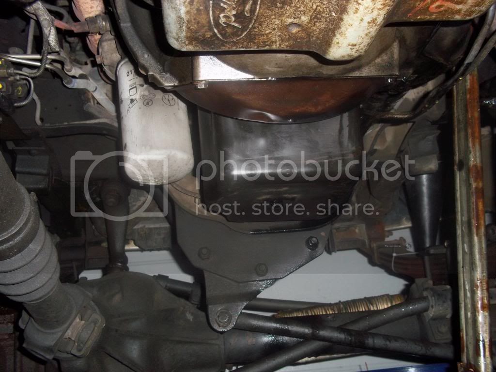

dont know if these pics help but heres the underside of the motor
89 Stroker
Feb 3, 2013
1,317
Southern Cali
You might be able to. It would be faster to pop the motor though. I would not do it in chassis.
that's the thing, i don't have the money or equipment to pull the motor in this thing, had the motor put it in by someone else so i don't know the headache it was doing it
bluedge8
3,879
Champlin MN
your stuck, you need to pull that motor, so it makes more sense to throw a junkyard motor in than try to fix this one. You may find that pulling the motor will actually be easier than pulling that head in chassis like you already have. The only other thing you could do is file down the head, pull the steel out of the piston and run it 'till she blows, because she will definitely blow! Do the motor swap now or in as few as a 100 miles, up to you.
7.3psd97444
3,361
Indiana
it'd be more a pain in the ass to lift it up in the engine bay several inches to get the pan off then it would to pull the whole thing. Find a lift to borrow or bite the bullet and buy one. That simple.
