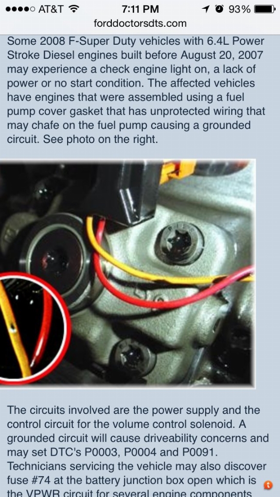

yeah most have been replacing that harness when changing hpop for years. its widely known.
Usually a chafed harness comes with a voltage DTC with a no start. His rail pressure is steady when he is WOT, even when the boost builds. So the way I see it, its not a volume issue.
I have a low/high voltage DTC code right now. Haven't even tempted to find it yet lol.Usually a chafed harness comes with a voltage DTC with a no start. His rail pressure is steady when he is WOT, even when the boost builds. So the way I see it, its not a volume issue.
