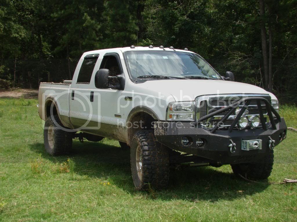

Just sayin... 37s wouldn't be too big.

The bumper needs to be much higher from the ground. What I don't like about using the 05-07 grill is that it drops considerably lower than the 99-04 version, and in order to fit a winch into the bumper, the underside is correspondingly lower.
To get the bumper from looking like it drags on the ground, 4.5" lift with TEI spacer and 37"s.

..careful with spacers..they throw the geometry out of whack.
..if you are going to put a lift on..do it the right way...please..
..I hate blocks in the rear of trucks...4.5" lift w/ 6" rear springs..no blocks
