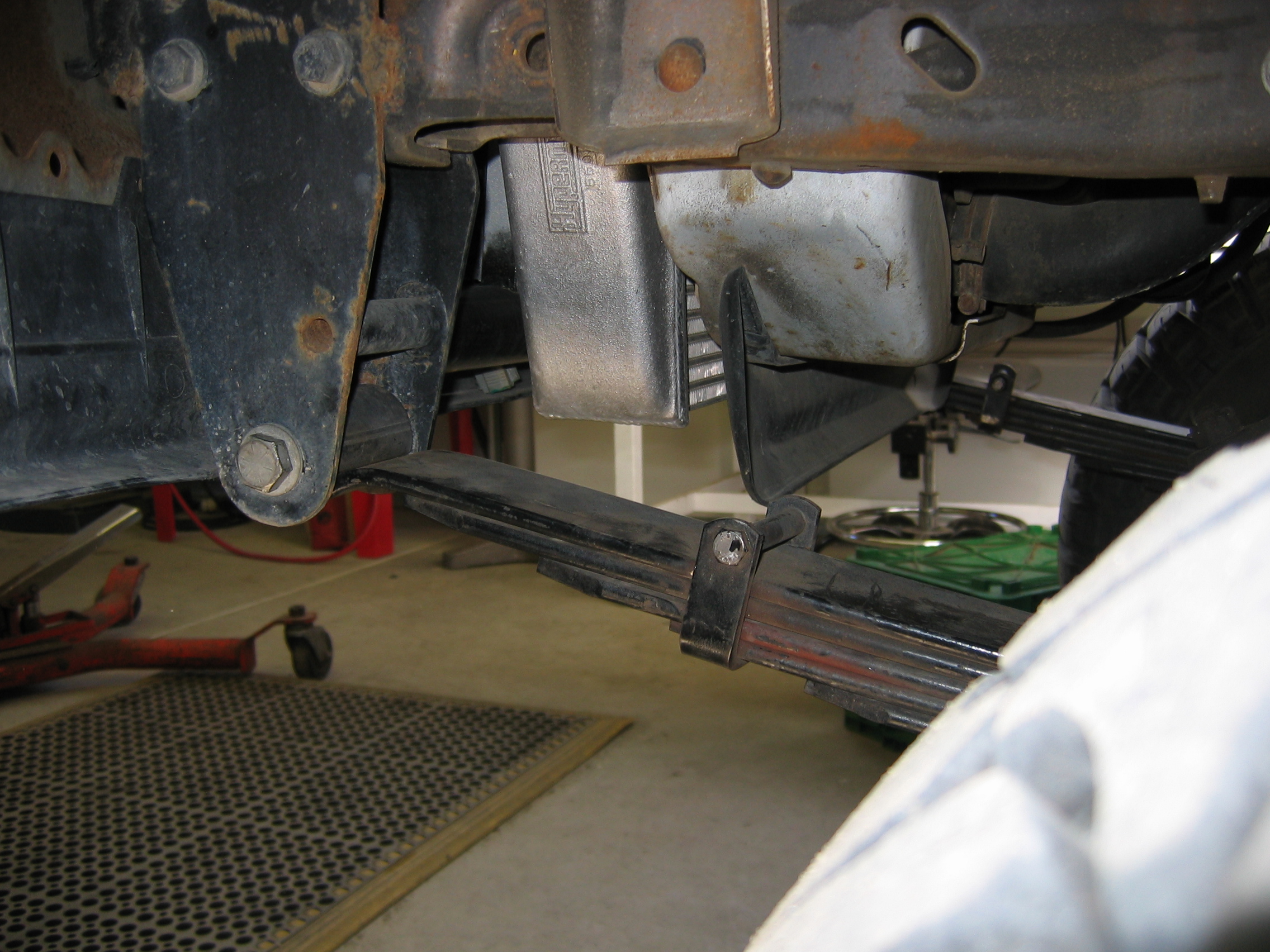

FYI, I ran a SD tapercore IC and never had any clearance issues..
You may have mounted your ic differently than I did. And your rsk crossbar is likely in a different spot than pmf's is. The bottom of my ic is within 1/4" if the bottom if the core support.
OBSWIZ
846
Wellington NV
Like this..don't think I could have gotten it closer.
OBSWIZ
846
Wellington NV
Should be between 1/2 and 3/4", I mount the IC's much closer to the Rad than how I see others do it so better air flow through the IC and more room for everything else.
