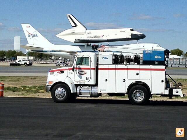

First of our heavy haul Pete's. I think they look pretty good.
