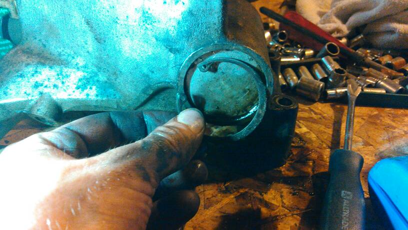

I didn't have them do anything else so I'm back to fixing my turbo leak. uploadfromtaptalk1469370013555.jpguploadfromtaptalk1469370020650.jpguploadfromtaptalk1469370028040.jpguploadfromtaptalk1469370034746.jpguploadfromtaptalk1469370045221.jpg

After church I'll pickup a bolt some Copper washers and a lock nut for the hole and put it back together.

Skip the washers and stuff. Just pick up a 1/4" npt tap. Tap the hole and put a plug in it. Much better.

National pipe thread. It a tapered fitting. For natural gas an such. The napa around me had one.

Gotcha, the hardware door I was at didn't have one and I already picked out the bolt and so what done is done.

That seems to have fixed it. Sounds much better. Gonna degrease the engine and keep an eye out for leaks but should be all set.
