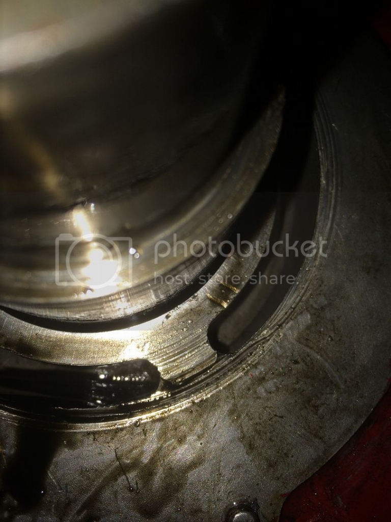

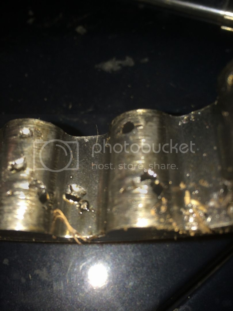

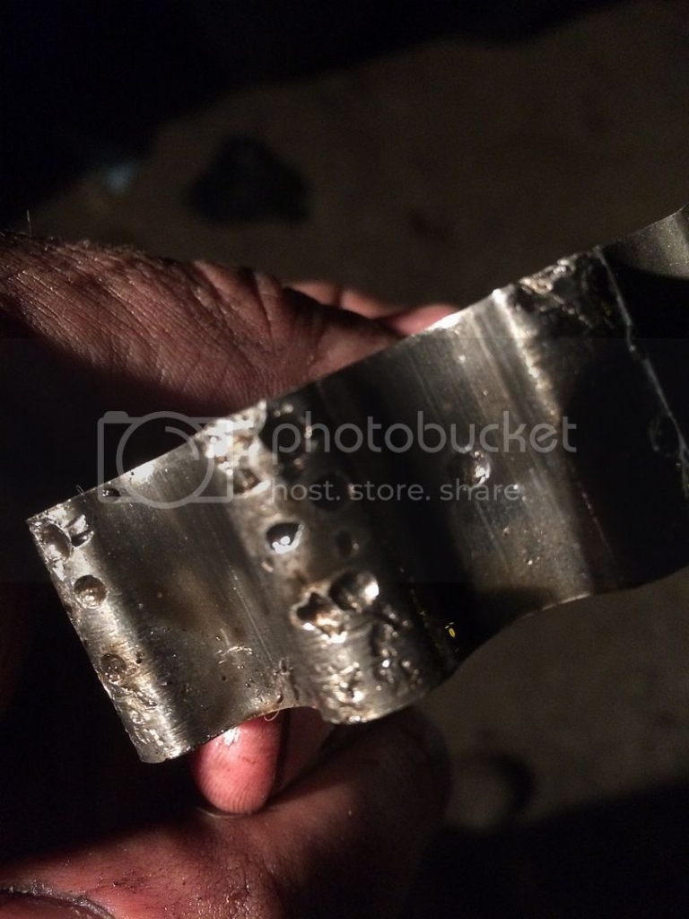

I could put another pump on but by judging the front cover, that's won't work. Replacing the front cover means pulling the engine.
Looking at the damage on the gears, looks like welding slag from welding the pickup tube. Only a guess.

Should have TIG welded it by professional.
