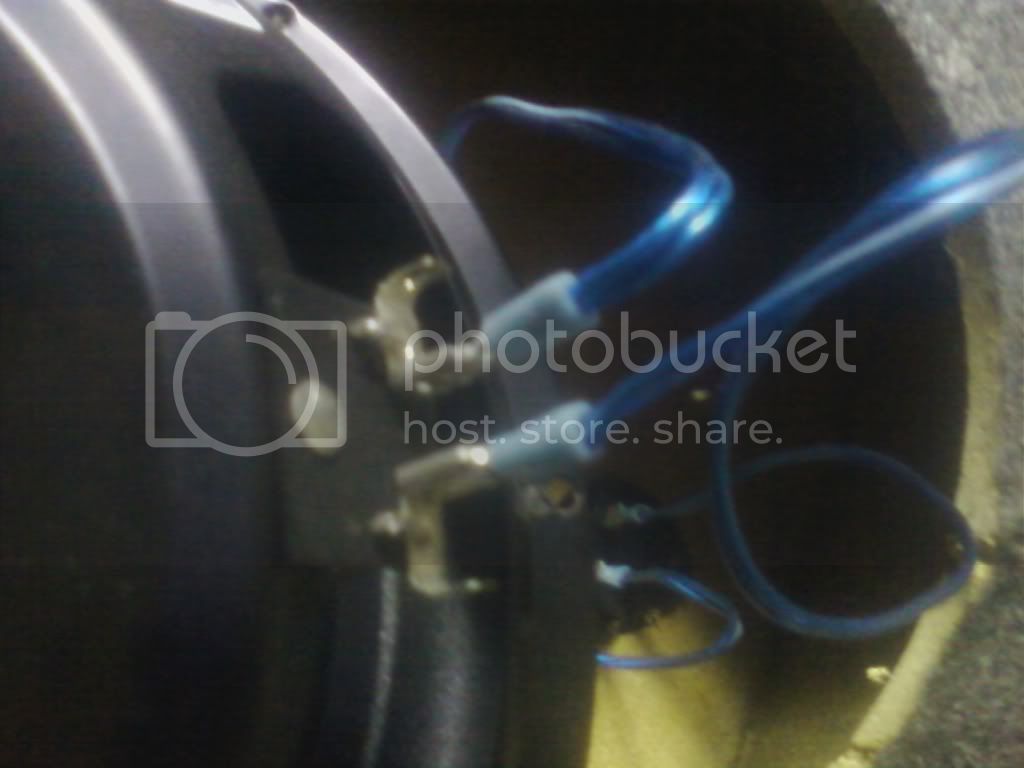

heres the hookup exactly how it was when i opened it sorry for the crappy cell pic

Your HU should state what it's output voltage is. The amp's manual should tell you the voltage range for the gain. The sub looks like a single voice coil.
damn then why are there two places for connections on each side?
also i bought the whole setup from a friend i didnt get any paperwork with it

I thought it was also hooked to the other side? Looks like double wires on each terminal. Get rid of the dental floss wires and get some real cables. Just my opinion.
