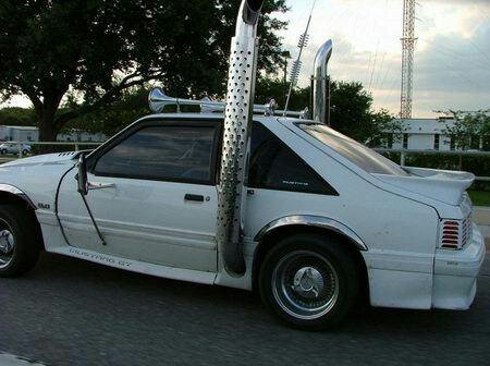

I wanted loud so this is what i did lmao.
Sent from the drivers seat.
