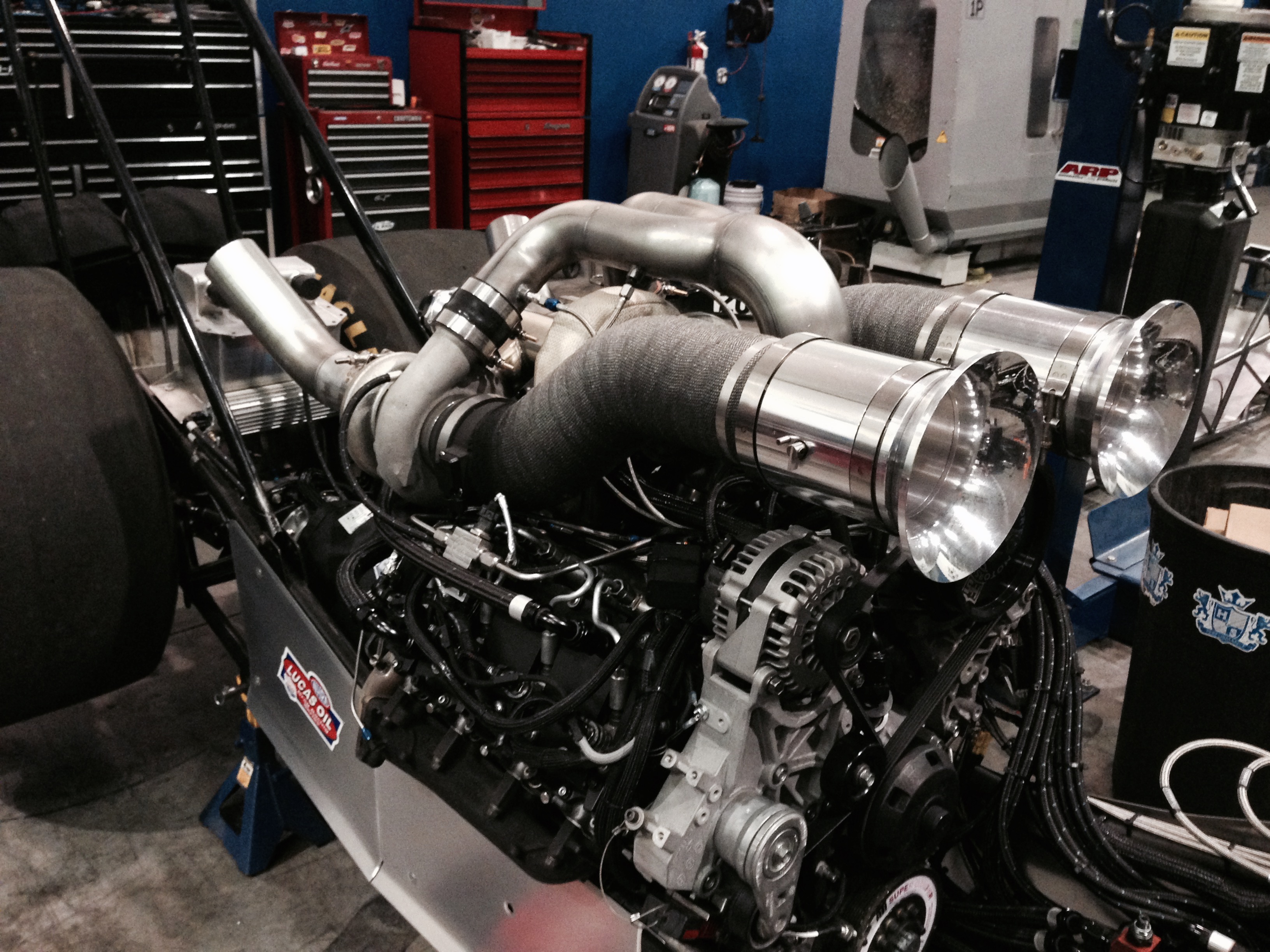

Whats the most miles you have on one of these turbo's? Anyone running it in a compound setup yet? Also is it duel BB, 360 degree thrust?

The 6.4 here has 54,000 miles on it with our turbo kit, same turbo since day one. Yes there are compound kits out there with these turbo's, not on a 6.4 yet.....and a triple turbo system being built right now with them. They are thrust bearing turbo's not BB. A little pic of compound porn for ya on the dragster....:) Let us know if you have any more question's, Thanks.

I had a set of trips built a few years ago with chargers very similar to these, not on a Ford but you get the idea.
