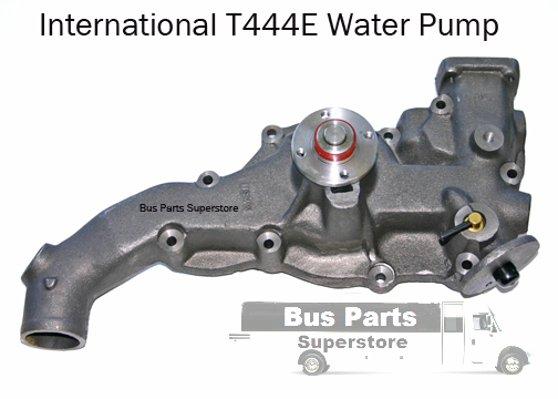

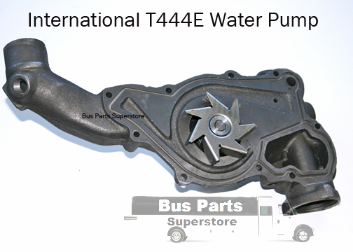

What about this one for $185?
http://www.international-powerstroke-bus-parts.com/proddetail.php?prod=1831676C92_water_pump
New International T444E Water Pump, part number's 1831676C92, 1889249C91 or 1823669C92. Fits 1994,1995,1996,1997,1998,1999,2000,2001,2002,2003 International T444E (7.3L) . This is a new water pump.
TyCorr
Jun 23, 2011
15,461
Similar deal right? I recommend absolute simply because I did business with them already.
