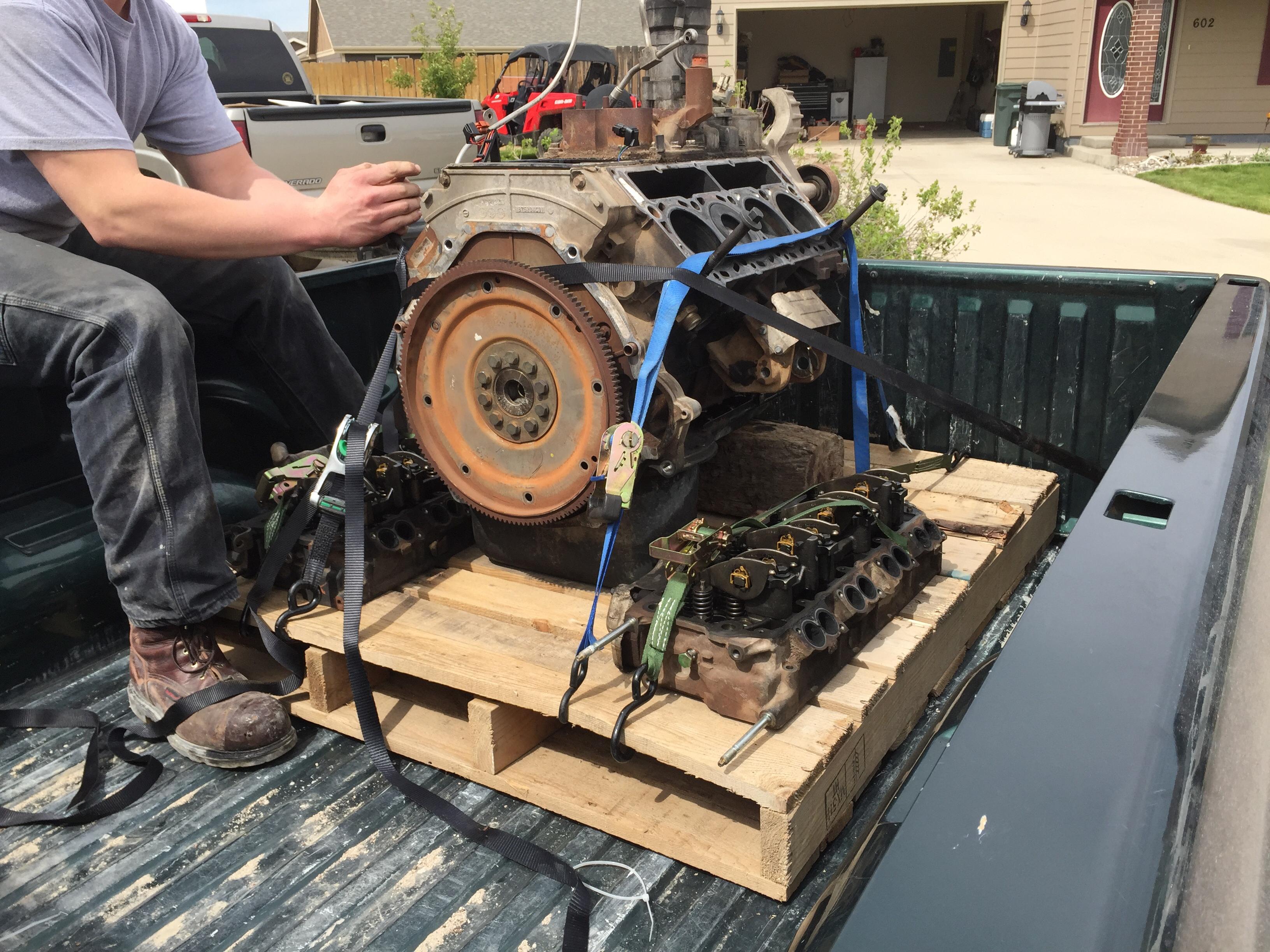

Got another up date. Was able to find a guy parting out a engine. I drive up to look at what he had and it is in really good shape for having 120k on it. The motor was pulled because it hydro locked. I looked the entire engine over and only noticed scuff marks at the bottom of the stroke on cyl 7 but they aren't bad and you can't catch a finger nail on them, so they should be able to be honed out. Also looked at the heads and they looked to be in great shape and couldn't see any visible cracks. So I offered the guy 600 for the block, rotating assembly and the heads and he took the offer. I'm super pumped I scored all that for 600 bucks when I initially budgeted for a new bare block and new heads. So now my grand plan is starting to take shape. Just gotta look for a machine shop that is good in the area to take the block too. Still won't probably be until August when I start to tear in to it, as I'm looking for houses and would like to rebuild it in my garage and not my apartment.

Yeah I can't go wrong with it. The block looks good and even if it turns out for some reason it's not I still made out because the heads are perfect, also I'll have two blocks, one will be built and the other might become a coffe table or an anchor lol

Damn, that is a good deal. Are you going to have the heads checked just to be safe?

Well I got the motor home safe and sound. Can't wait to start to tear it apart. Might take the heads apart on a lunch break this week
