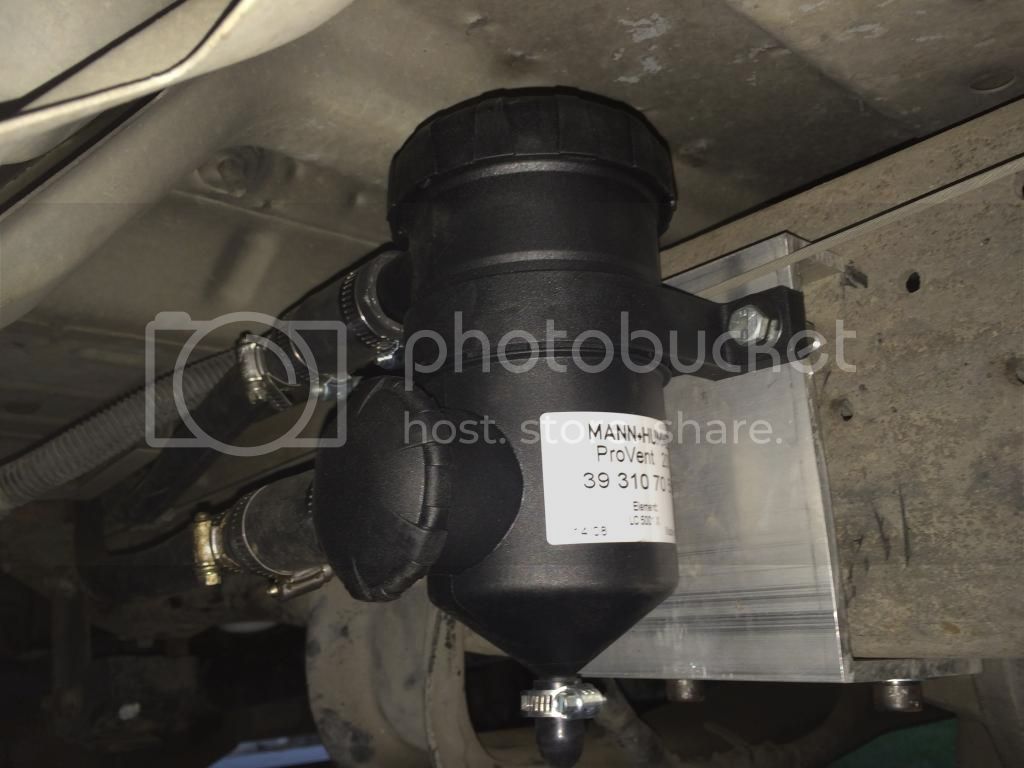

I purchased just the canister they use. It is manufactured by Mann-Hummel and the model is Provent 200. Cost was around $140 shipped. It is working great so far. Here is how I mounted it.
Please more info on your setup. So it reroutes back to the intake?
Justin@DP-Tuner
Jun 22, 2011
2,170
Yes.
Get...
-12ft of 3/4" hose (cut in half)
-6" of 1" hose (cut it in half)
-two 3/4" to 1" hose adapters
-one 3/4" to 3/4" hose adapter
-one 90* 3/4" hose elbow
-hose clamps
I made the aluminum bracket myself, but you can get creative there and use whatever you would like to mount it.
Flip the CCV doghouse around just like you are doing the normal vent-to-atmosphere CCV mod. Run the hose up over the brake master cylinder and down the frame (takes about 6ft of hose). Mount the canister wherever you would like and attach the hose to the IN port. The ports on the canister are 1" so this is where you will need to use the 3" piece of 1" hose adapted to the 3/4" hose coming from the CCV doghouse.
Connect the other 3" piece of 1" hose to the OUT port and adapt it to the remaining 6ft of 3/4" hose. Run this back up to the intake. You will need to connect the 90* 3/4" hose elbow to the intake tube and then connect the 3/4" hose coming from the canister to that.
That should be all there is to do. Hopefully my instructions are clearer than mud.

After going on Mann-Hummel's site, a Provent 400 is better suited for a modified truck. Just need to find a Provent 400 at a good price.
Billy T.
[email protected]
Billy,
The Provent 400 canister is 7.5" wide and almost 12" tall. The inlet and outlet ports are 1.5". I don't know if you will be able to find a place to mount that canister, and I think it is a bit overkill for our trucks.
Check out the size comparison.

Is there a valve that you can put on the bottom of the canister for draining? How often do you drain it?
Justin@DP-Tuner
Jun 22, 2011
2,170
Yes. You can put a piece of hose on there and install a drain valve. I just have a nipple over the end until I find a valve I like.
It would be a good idea to drain it every oil change.
