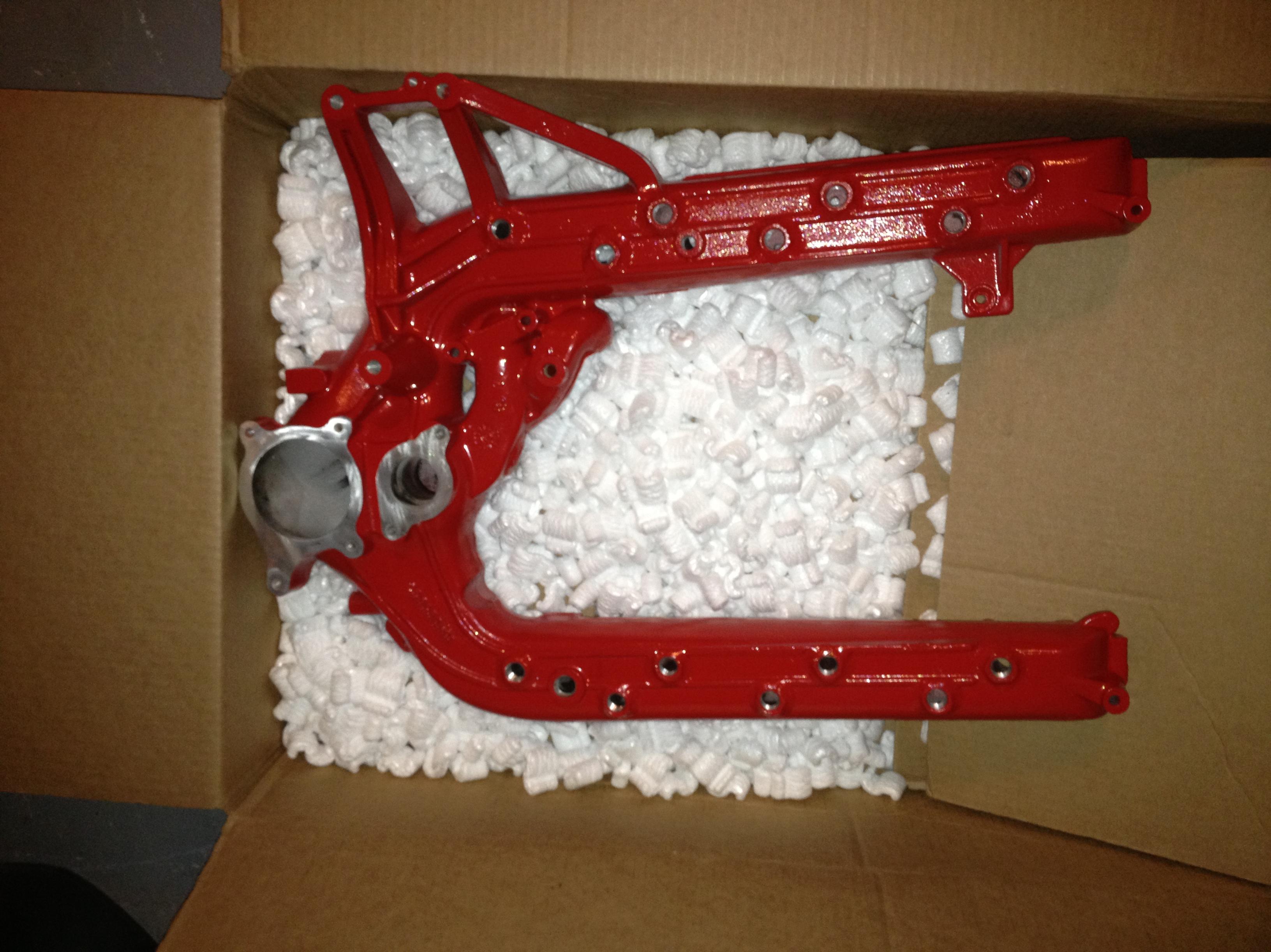

I just received this in the mail yesterday. It took about a month to get it. Price was $500 + $200 for the core. Looks great, and seems to be ported all the way thru.
Got it thru the Diesel Dr. Josh was the point man.
This will be going into my truck along with some other goodies. I wish there was a realistic way for me to drive the truck with it on there by itself and report the difference....
