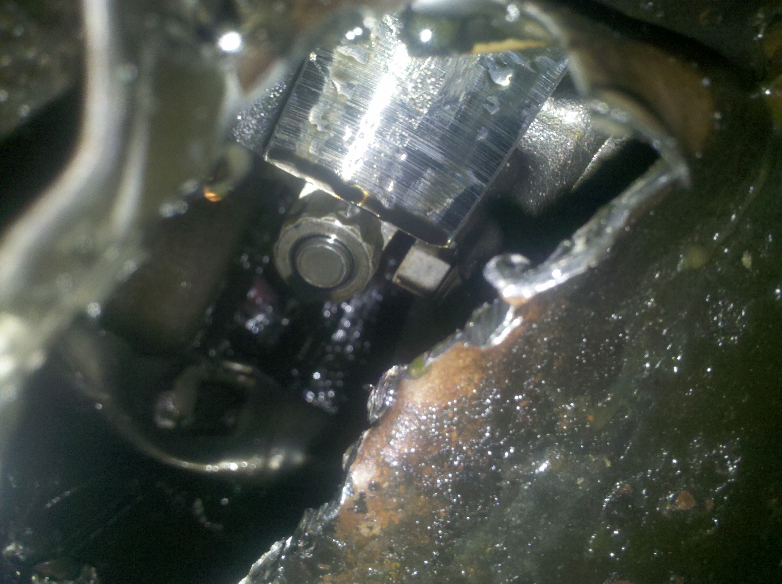

Agreed but a naturally laggy turbo would help wouldn't it?
The lack of RPM's on the street aren't going to get enough air flowing, and the engine is going to run hot. Exasperating the issue especially in those front 2 cylinders, where the air flow is the worst.
What number hole did that rod come out of OP?
97stoker350
Dec 1, 2011
2,061
south central pa
Mine threw number 3
Well technically it didn't "throw" it but mine pulled appart right below the wrist pin then had a field day after that
02BigD
3,255
Coastal NC
Mine bent 1,2,3 cryo'd and shot peened rods. Tunes from someone not mentioned yet (no Joe, it wasn't your friends).
