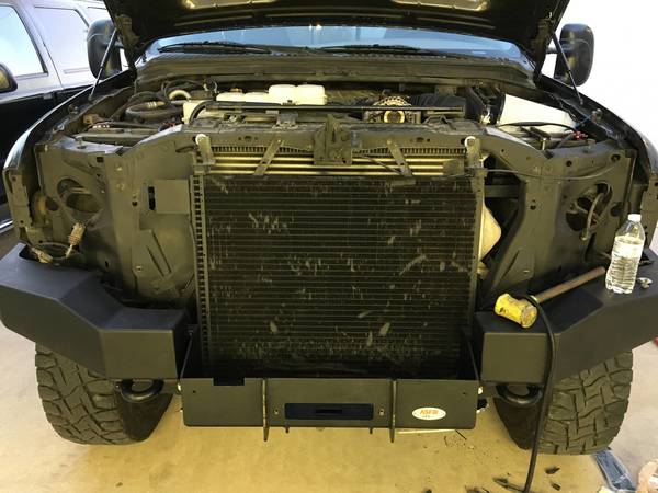

Did a little bit of work this weekend
Cleaned up the front end while installing the winch. To fit the winch you either removed the bumper or removed the header panel.
After
Winch will hopefully be installed tomorrow.
