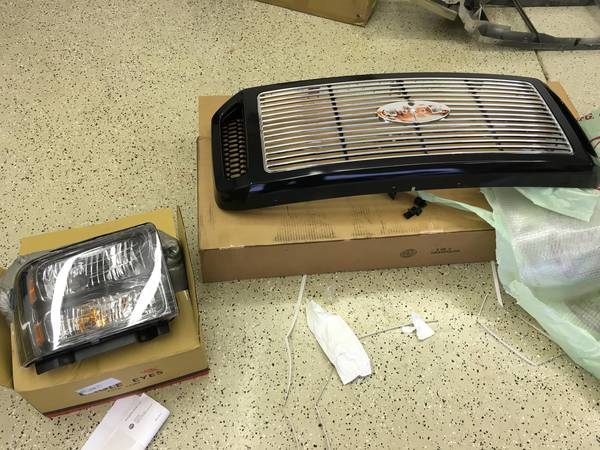

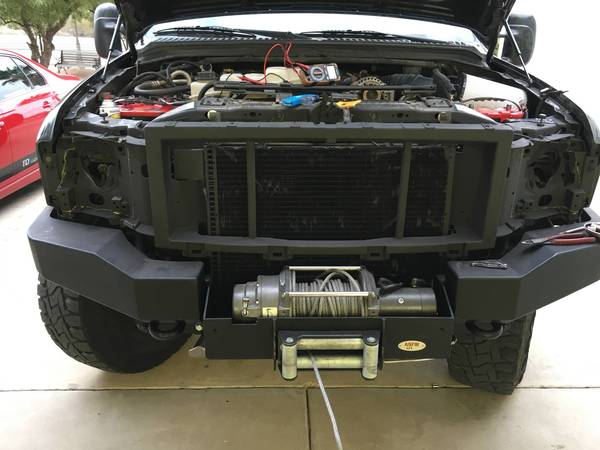

Finally got the winch in, ordered HD headlights and a HD grill. Will be painting the inside of the headlights the same color as the truck, and add some things to them as well:rockon:
Also marked where to cut to fit the headlights
Grill needs to be trimmed and painted still, so the old grill is still in use.
How it's sitting as of now.

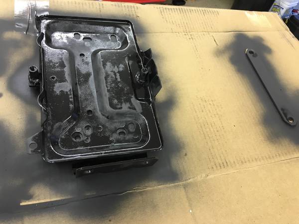

Always liked how the AFE intake clamps the battery down with a piece of flat stock clamping the battery down. Being this truck will see heavy use offroad. I decided to make my passenger side battery clamped the same way.
My helper for the day lol
Passenger side battery tray, welded nuts on the front and back, cut some flat stock and will be using 3/8 bolts to hold it down, battery is going nowhere!

Do you have to trim some of the facia to get the HD lights to fit? Ive never really studied this, but thinking more about getting a set. my bezels are getting pretty tired.
Jomax
8,576
Arizona
Yup, you need to cut the header panel and get pigtail adapters, also if you buy aftermarket headlights but a bead of silicone all the way around he lens. They wicket sealing them.
Cut the header panel. Easy with a dremel
Either swap the header panel or cut. Both are easy.
Yup
