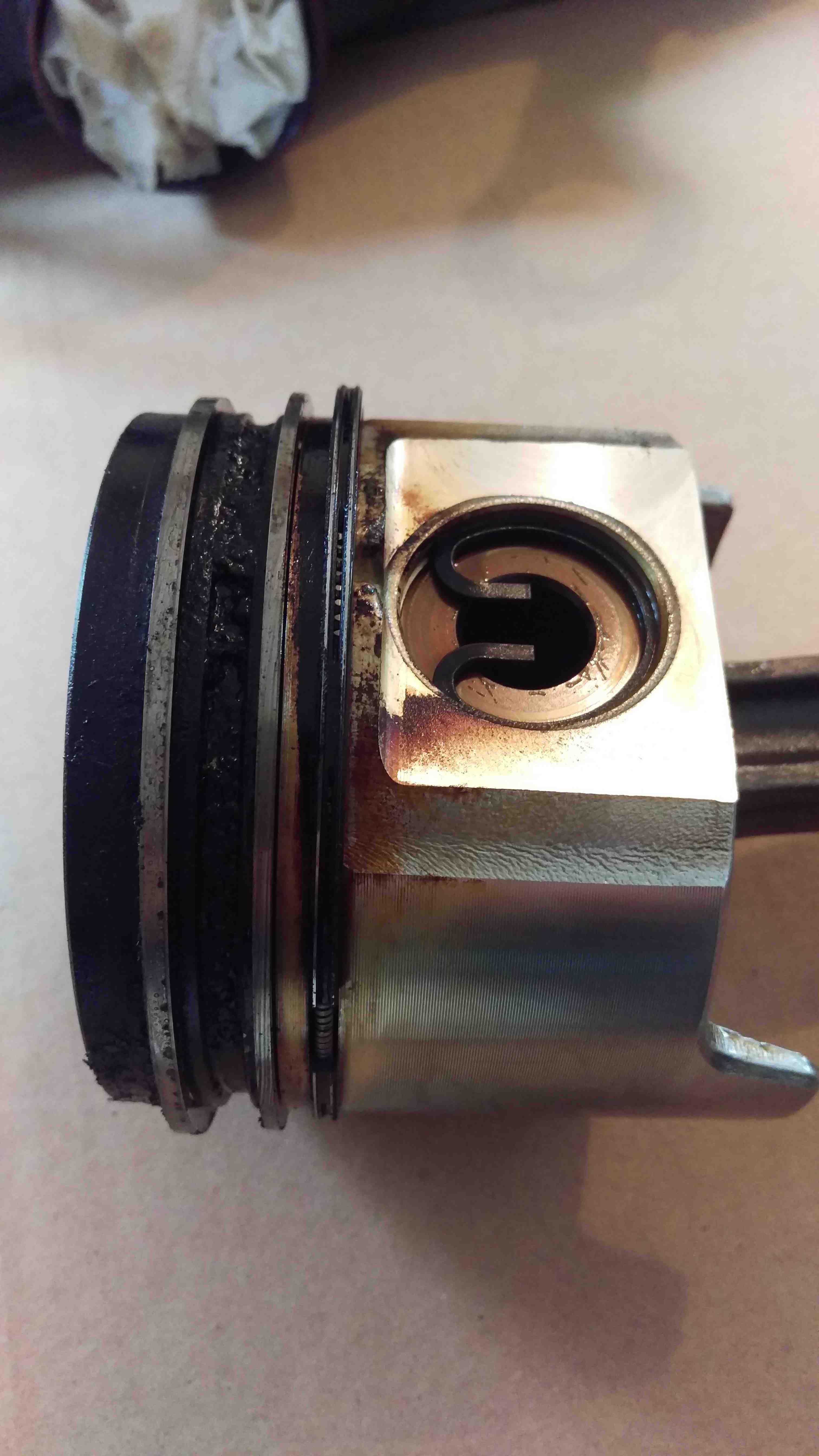

I'm posting a pic of the number one piston. If you look closely, you can see carbon buildup only in the area under the compression ring end gap; which was 39 thousandths. If you take a close look at the surface of the compression and scraper rings. They have tiny pits and what I will call random and extremely shallow areas that are eroded. This is new to me. Has anyone experienced this? What would cause this?
Click on pic to open and then click again twice to zoom in real close.

The top compression ring gap should be anything from .013 to .045. Within spec but a lot of gap.
uncool
Jul 22, 2011
273
California
Top - .014"-.024 Second - .062"-.072" Oil Ring - .012"-.024"
Those are the ring gaps you should shoot for. This is from International's website.

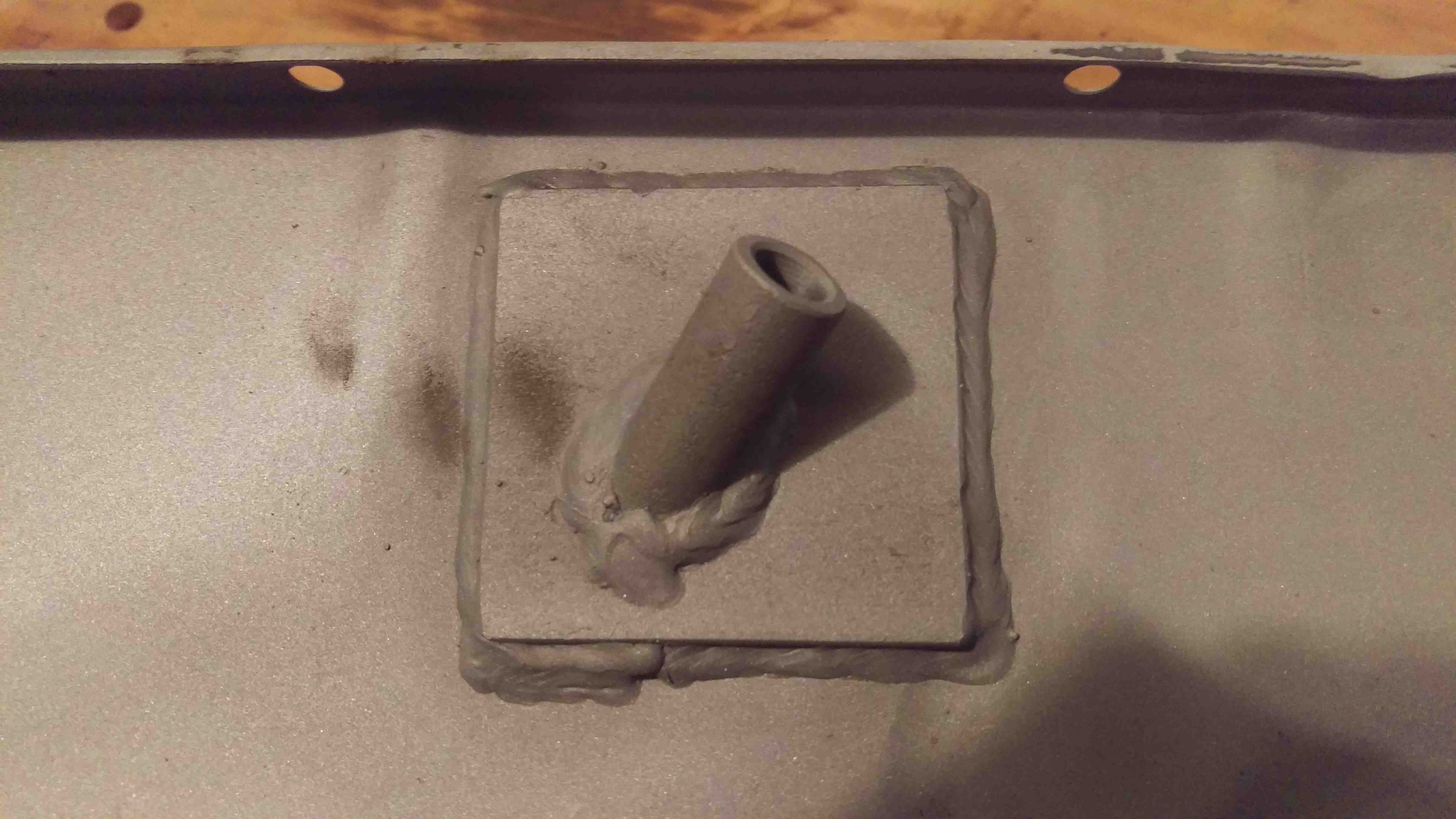

Here is a pic of the Oilite pilot shaft bushing and dipstick tube adapter. The adapter is not pretty, it's just scrape stock I had laying around. But, it works.
If your welds are leaking, you either have a cold weld or porosity? I tested mine with diesel fuel, all is well. I did weld it inside and out.
