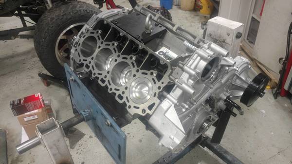

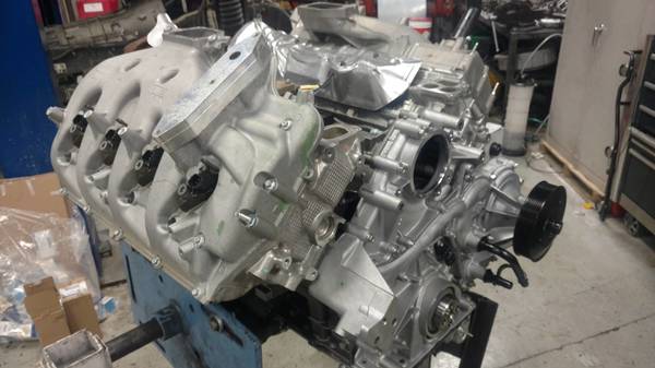

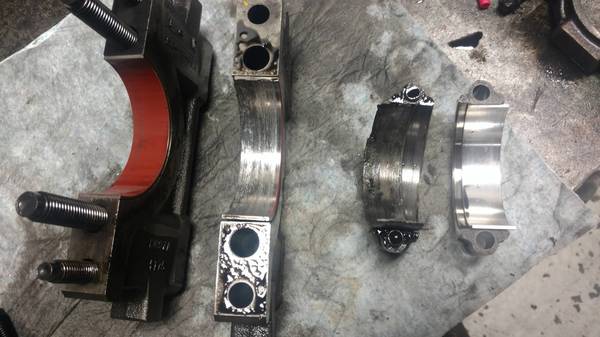

The short block showed up yesterday, but I couldn't touch it until today because of some other vehicle taking presedenece. I was able to spend most of today on it though.
These bearings are all from Erik's motor. I thought you guys might like to see the difference.
New '17 short block requires larger mount bracket bolts & brackets, as well as water pump plugs, and a couple other little things.
Just a little more work in the morning, and it'll be ready to install.
Were that rod and main near each other (the failed ones)?
Wayne
2,540
8
Twin Falls, Idaho
The pictured rods were on different journals, as the two that failed, shared a journal. The good one pictured was cyl 6. 3 and 7 failed. mains were "next to" each other. BTW, I'm not looking for somebody to diagnose the cause of failure for me, but anyone is more than welcome to speculate. :thumbup:

I strongly suspect the oil pump failed on that one Bustedknuckles. There's a TSB out there requiring a bunch of the '17 power strokes do an oil pump function test involving a 2400 - 2500 rpm 1/2 hr+ high idle, then an 8 hour cold soak and restart while monitoring rpm's and the low pressure oil switch. They anticipate it affecting less than 1% of the trucks, but that must have been in the 1%. This one is most likely a spun rod bearing as the root cause.
Wayne
2,540
8
Twin Falls, Idaho
The truck's been done for a week now, and runs great. As I explained earlier, it spun a rod bearing, causing other subsequent damage. Oil quality was not to blame, so suspicion lies in insufficient bearing crush. We're just waiting on some paperwork on Erik's end involving lost documents needing duplicates and other hoops to jump through for warranty coverage, then it's back home to Cali.

Yeah, no identifiable user error. Nothing anyone could've done different in maintenance or driving to prevent this one. Just bad luck. Thankfully this is a very rare situation on these newer 6.7's.
