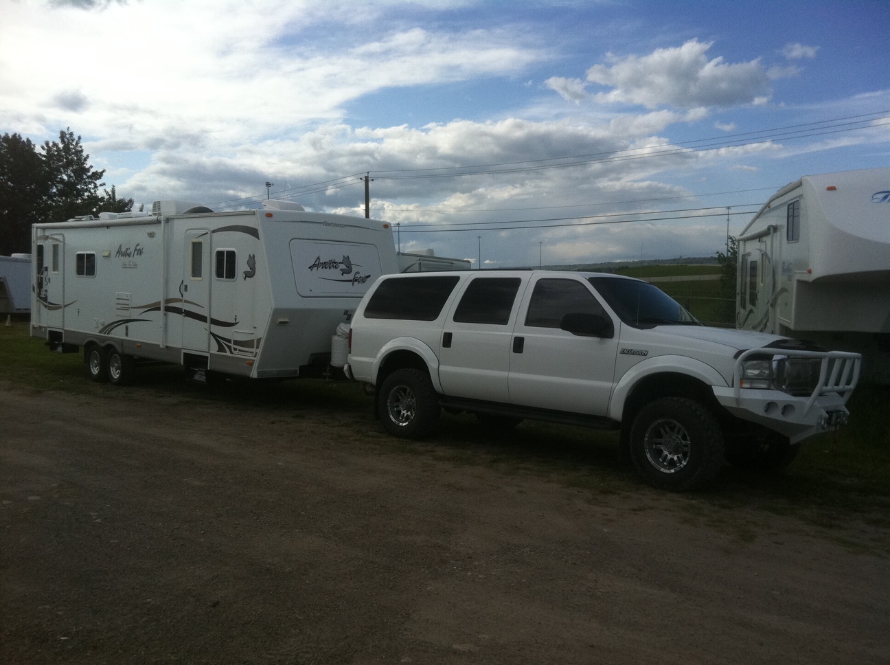

Jason, how well does it tow your toy hauler? Do you know the weight when you have it loaded up? I'm thinking about pulling the trigger on a 30' toy hauler. Do you have airbags in the rear?
Well, lets just say there is still lots of room for improvement. Its predictable and manageable - but I'm not really comfortable yet.
The only time I've been over the scales, my GCVW was just over 20k lbs, but that was not fully loaded. The trailer's GWR is 13k...
The rear is stock, I have v-codes up front and MX6 shocks all around. Plan to install modded b-codes, Hellwig sway bar, Landyot Radius Rods ASAP. Air bags if necessary, but should not be needed. I will also be using a Hensley or ProPride hitch.
The biggest problem I have to attempt to overcome is this trailer is 37ft tip to tail! Thats just alot of leverage on the short X wheelbase... I am confident you could set up your X to comfortably pull a 30ft TT. :thumbup:

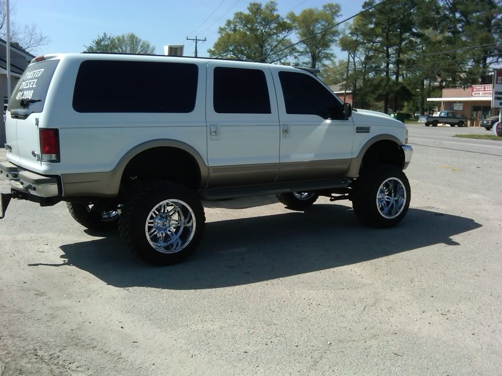

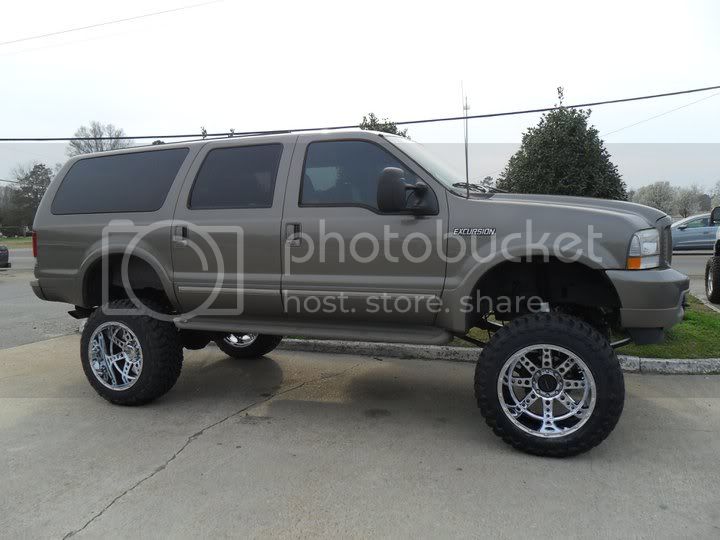

Here is ours, White one..My spring mods and 35" on 20"
A customers same but on 33" on 20"

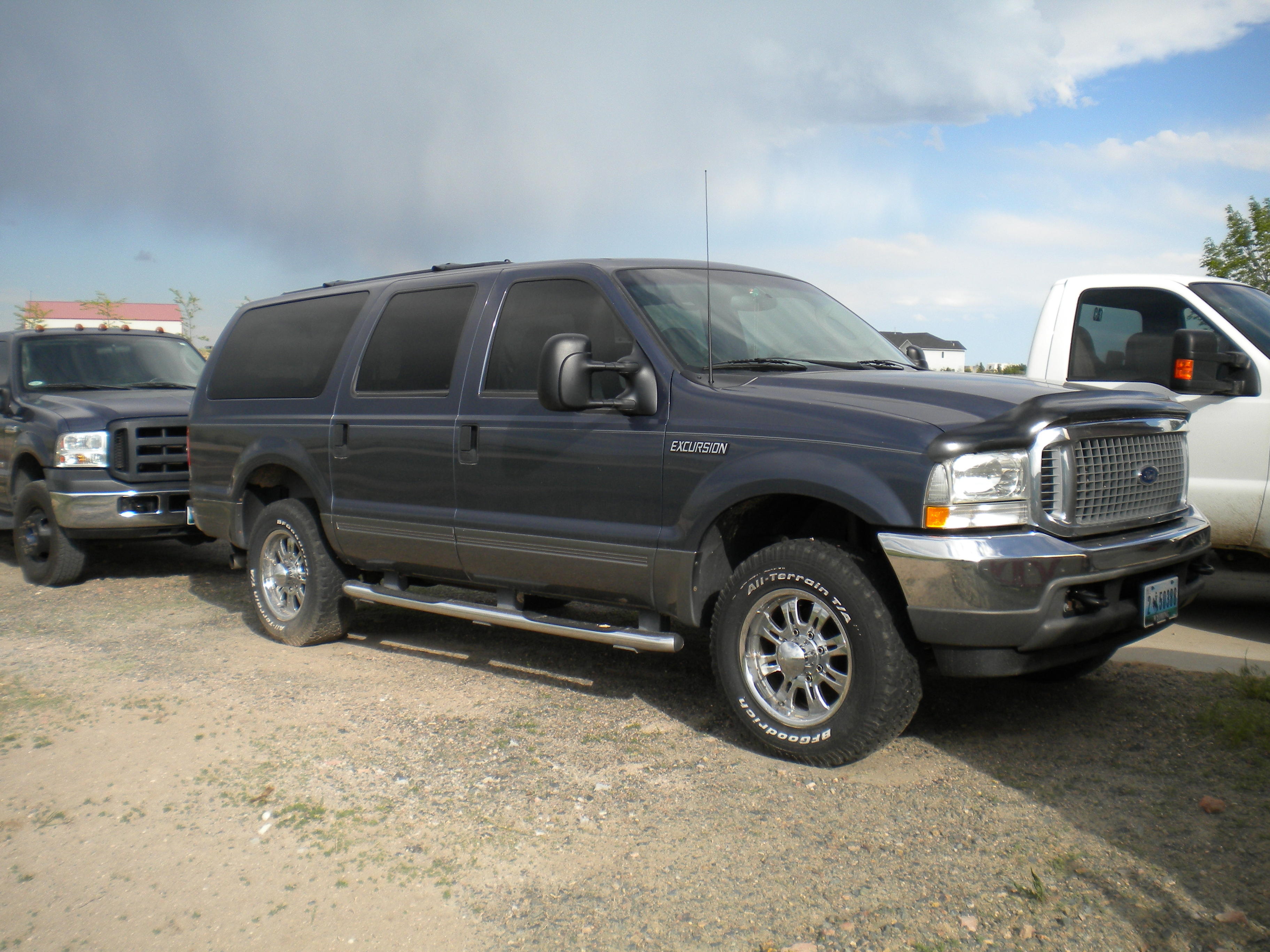

ok second time is the charm

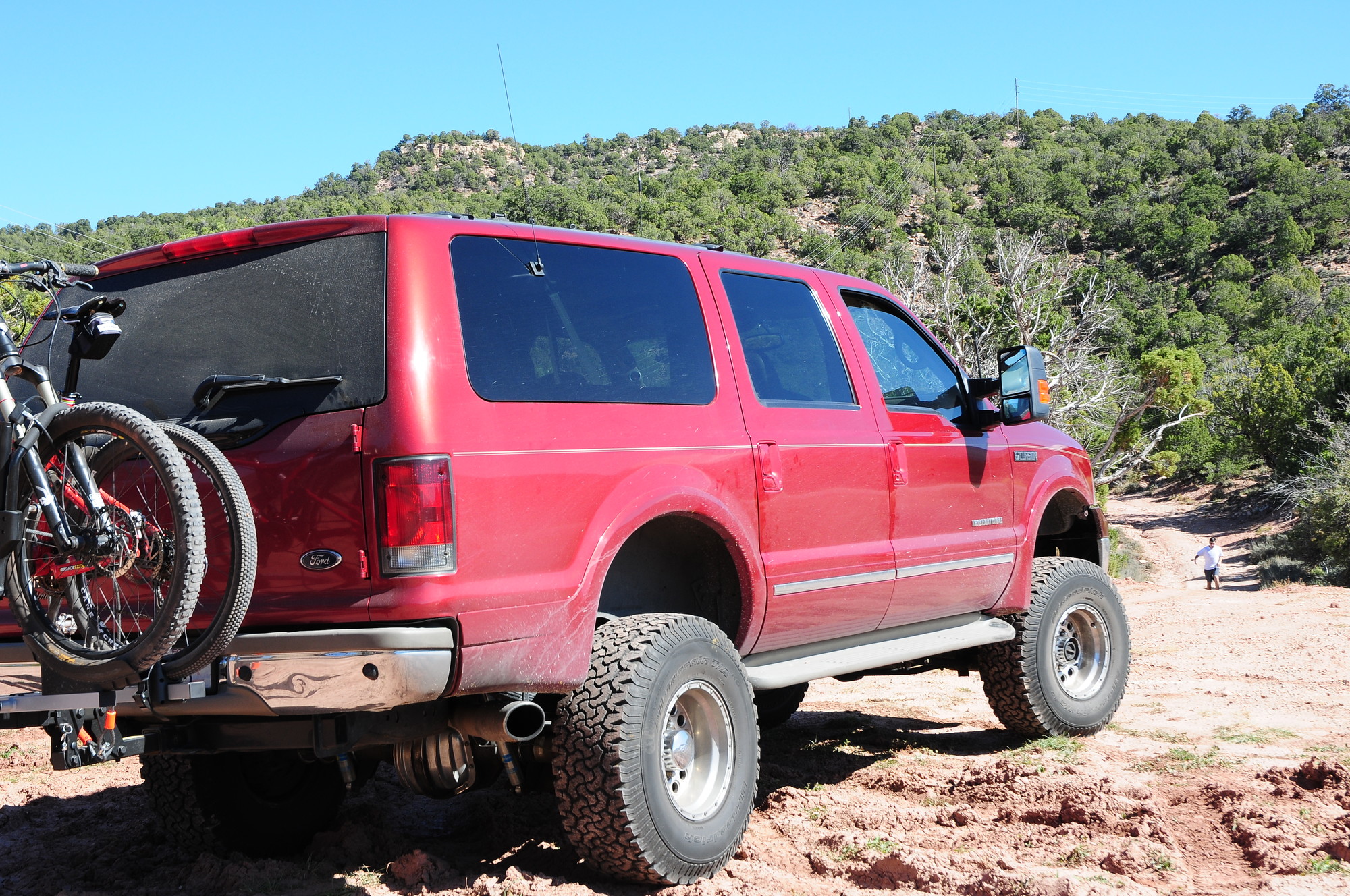

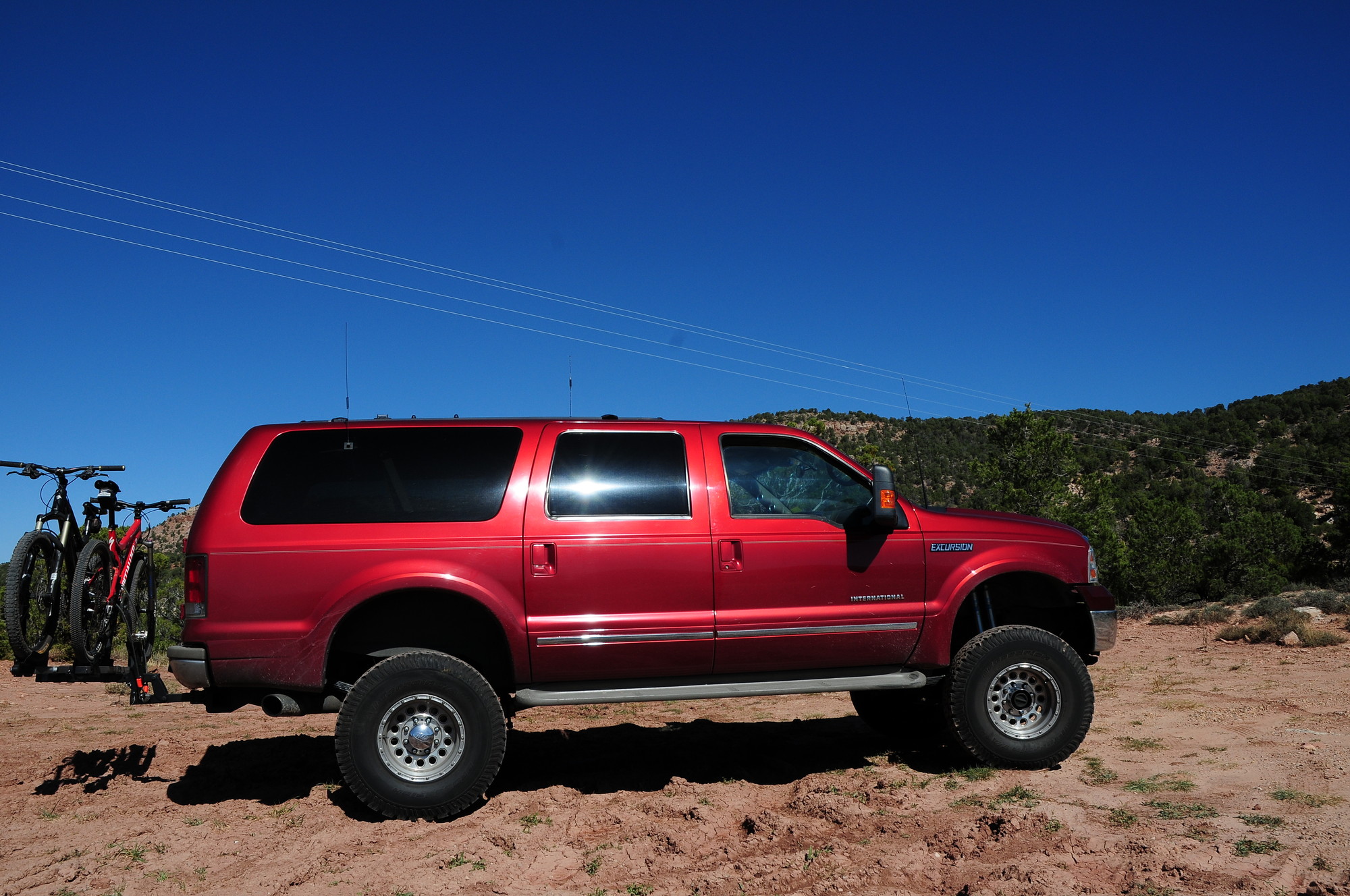

Here is a month old shot in Moab Utah. I have Wheels and Tires going on soon and when I have some down time I have some motor mods..
I am planning on doing new carpeting this spring.. I was thinking of deleting the rear carpeting in favor of flat steel diamond plating or something similar. Could always put carpeting back in.
