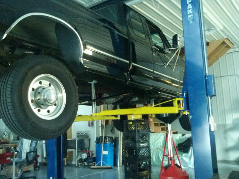

Where do you place the lift arms to lift the truck? There is no frame showing on the driver's side, it's covered with the fuel tank skid plate.

The duallys are more of a pain than the srw trucks for some reason. What size lift do you have? I use a 15k and a 12k at work that are 2 different styles, the 15k lifts most of yhe trucks i need to lift. On the 12k with duallys i need to pull the skidplate on yhe ground. I have never tried lifting one on a standard 9k car lift.
