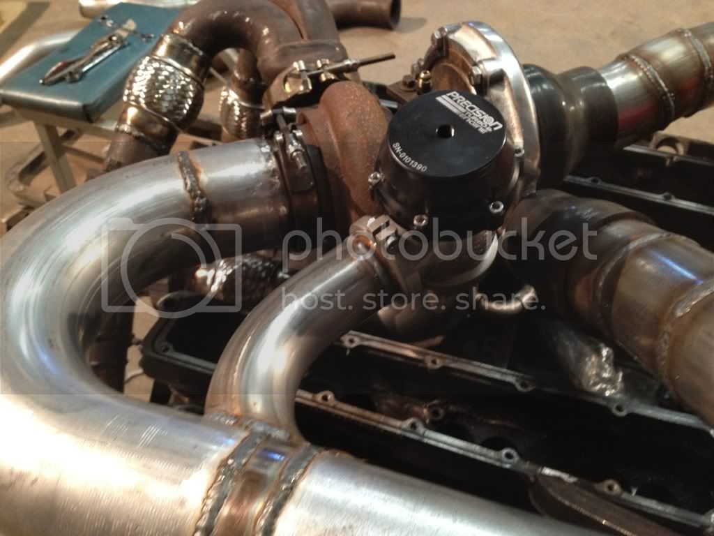

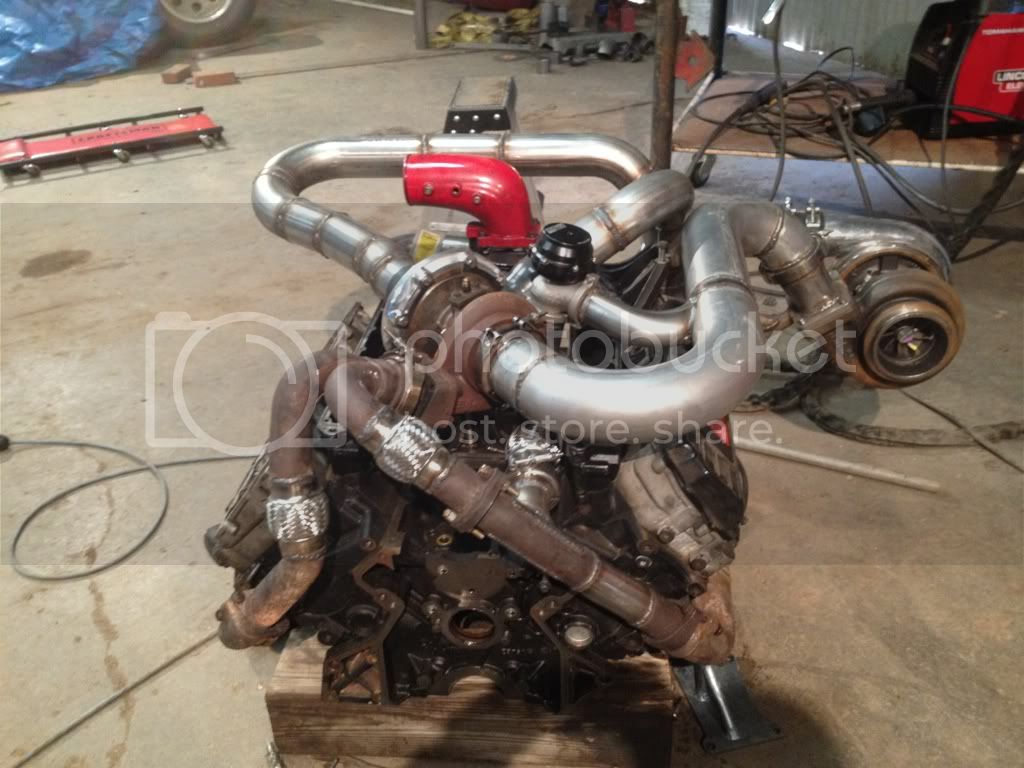

Get an E.d. t3 flange with a wastegate provision, done.
...and how do I run the pipe? It would prolly hit the hood if I go over top of the turbo....and not sure how I would get my fat hands into the back to attach anything if I plumbed it towards the firewall, and around the back...
What size? 38mm...40?

this is how I do mine
