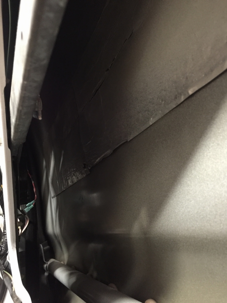

I cut the BXT and Ensolite for the front doors. It's been way to humid here to actually install anything.
On another note, just doing the rear 2 doors, the dB meter on my phone dropped 3-5dB between 70-80 mph.
Sent from my cracked iPhone using Tapatalk
Cknox121
Apr 26, 2013
1,748
Augusta GA
More progress. Did the front 2 doors. 150% coverage with BXT on the outer skin, followed with a couple strips of Ensolite. RAAMat's site says to only use a 8x8 piece behind the speaker, but I covered around 50% of the door. For the inner skin I used a layer of BXT, 100% coverage and layer of Ensolite, 100% coverage. I also reapplied the factory MLV if that is in fact what it actually is on top of the 2 layers.
After completing all the doors, it was made a huge difference! I was able to carry on a casual conversation at normal tone and hear my passenger easily. Tire noise is very minimal.
Although it is quieter, the back was "noise" and under the dash is more pronounced. I will target the back wall when I have time next.
As a hind sight, I wish I would have did 150-200% on the outer skin in the back doors. The fronts are noticeably more solid sounding when tapping on them.
