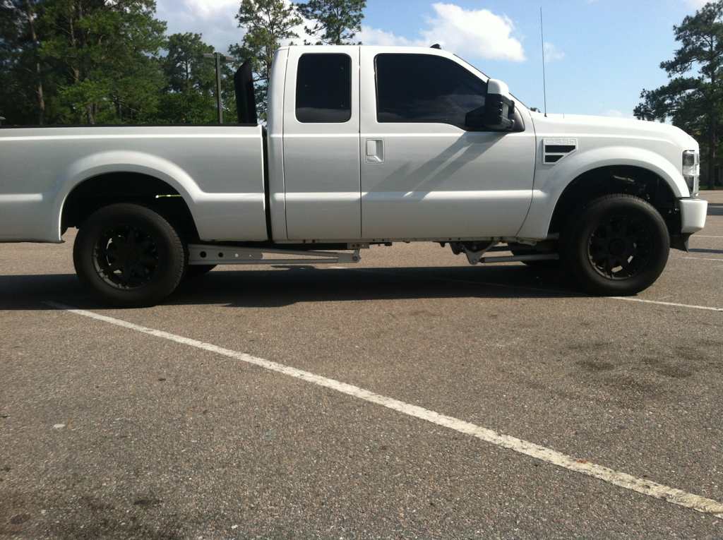

I have an 09 f250 ex cab and did the #4800 and remove block. Def sits a little lowwer in the back. Prob going to add 1/2 to 1" block.

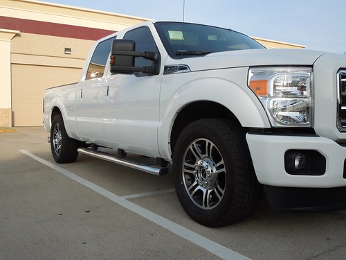

2012 FX4- 3" Front and 3.5" Rear.
Drives great, but I'm raising the front .5" with a stiffer spring to make it more level and avoid the stops. I'm not using the Ford springs, ordering a second pair from Deaver.
Went from this![]()
To this
the truck looks awesome!
how did you lower the rear?
what tires are you running?
can you explain more on the deaver front coils?
what shocks?
Thanks- I like it alot, drives much better and I have no plans to go off pavement so the reduced travel is not a concern.
For the front, I ordered coils from Deaver to match the factory spring rate and lower the truck 3". I'm ordering a second pair that will be 15% stiffer and 2.5" lower.
In the rear- I removed the factory block and added a DJM shackle.
Shocks are Bilsteins, also ordered from Deaver to match the lower ride height- I don't know who built the shocks, Deaver commissioned them. They're a bit stiff in the rear. Front is good. Also installed Energy Suspension bumpstops- thinnest ones they sell.
Tires are Falken Wildpeak 305/55/20
