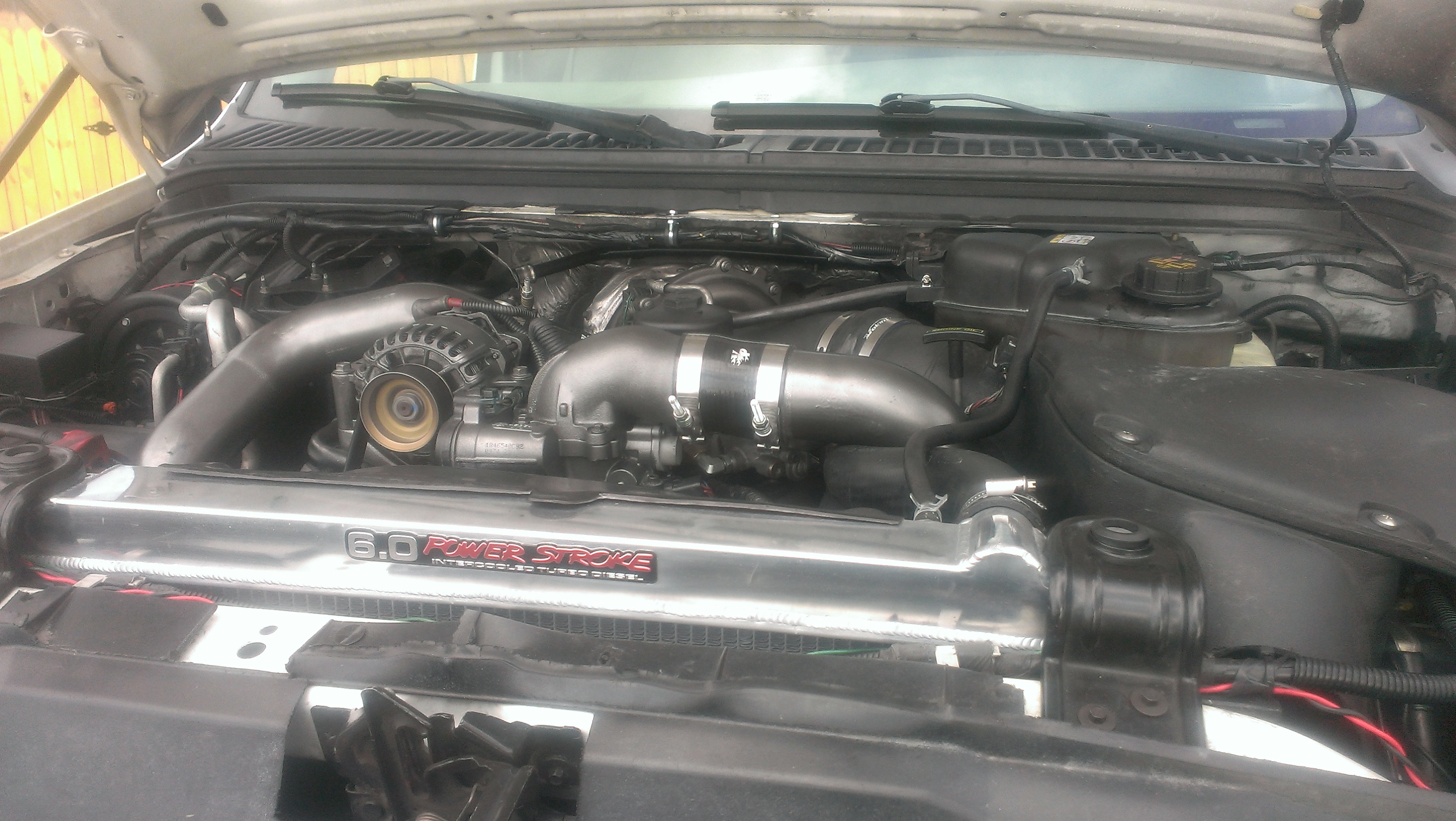

yeh yeh, I know I spelled Purdue wrong, too may laughing skull beers. Here's some pictures of the engine bay of the truck.
