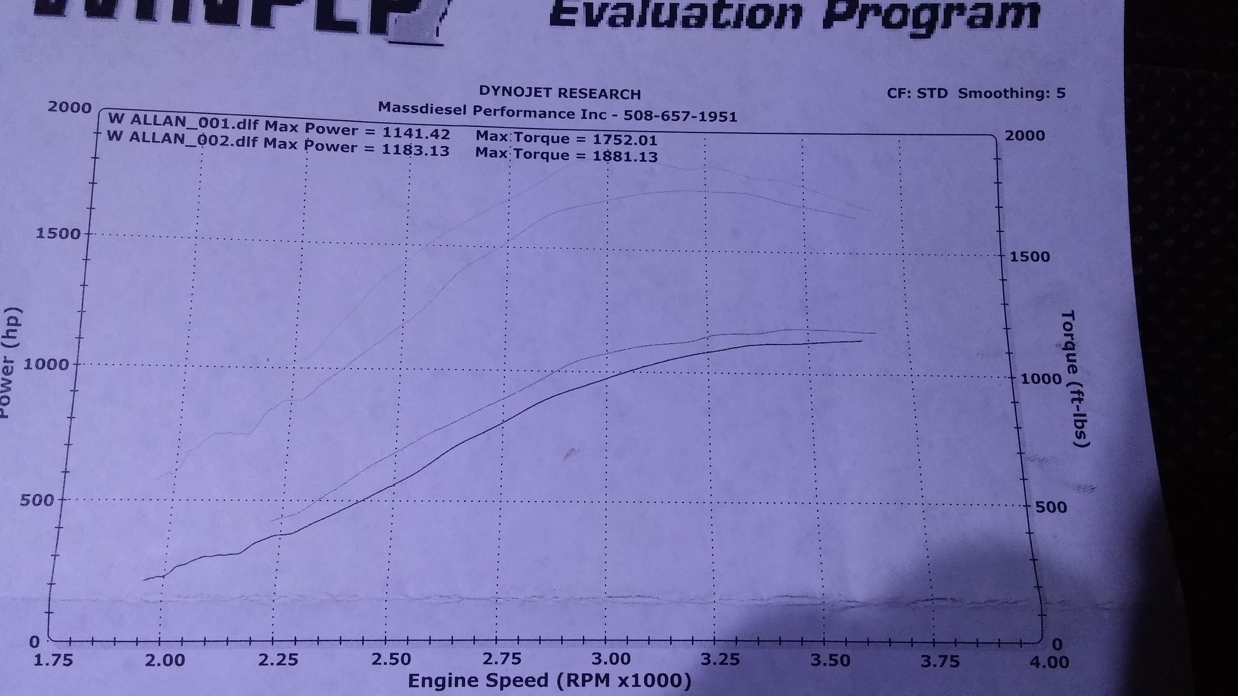

Amazing what some good weather and proper waste gate adjustments will accomplish. Saw my big turbo make like 50lbs of boost. Sounds insane sitting in the passenger seat near that intake tube with no filter on it.

It really is, I was shocked. Realistically it's just a number, and I do keep that in mind. I need to get to the track some day. If my mph could equate to even within 100-150hp of that I'd be ecstatic. Only downside is I have no experience racing so there is going to be a learning curve!

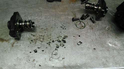

So truck ran fine without the second pump running.... How worried should I be about the injectors? What do you guys typically do to prevent further damage if there is metal in the system? Any way to clean the injectors?

Yeah pull rails down and clean them out. That really sucks :(.
This is also another reason we run a single line in our setup. This way the contaminants only go into one rail if a pump fails.
I have a pump but will need control valves
Oct 1, 2012
5,868
Athens, IL
Just flush the system. Same reason we tell people not to reverse a used pump. Bad idea(not saying you did or not).
Only one way to find out. Only thing one line will do is destroy one whole bank and holds the nozzle open to melt pistons one one bank. Either way your still have to build a motor.
Feb 12, 2012
655
Richmond IL
I disagree .... It all depends on what way the pump fails...
Oct 1, 2012
5,868
Athens, IL
If the pump fails internally without a plunger and barrel failure then it doesn't matter what line arrangement you have. It will stay contained.
If you have a material failure in the plunger and barrel the only thing your doing by only feeding one rail is just contaminating one bank completely to failure instead of both equally. Either way your going to ruin stuff.
If you only stick a nozzle open on one bank instead of two you still ruined the engine. On our kit you can still only ruin one bank. It would have to go completely through the other k16 to get to both banks if only one pump fails. Either way if you hang an injector you are screwed.
