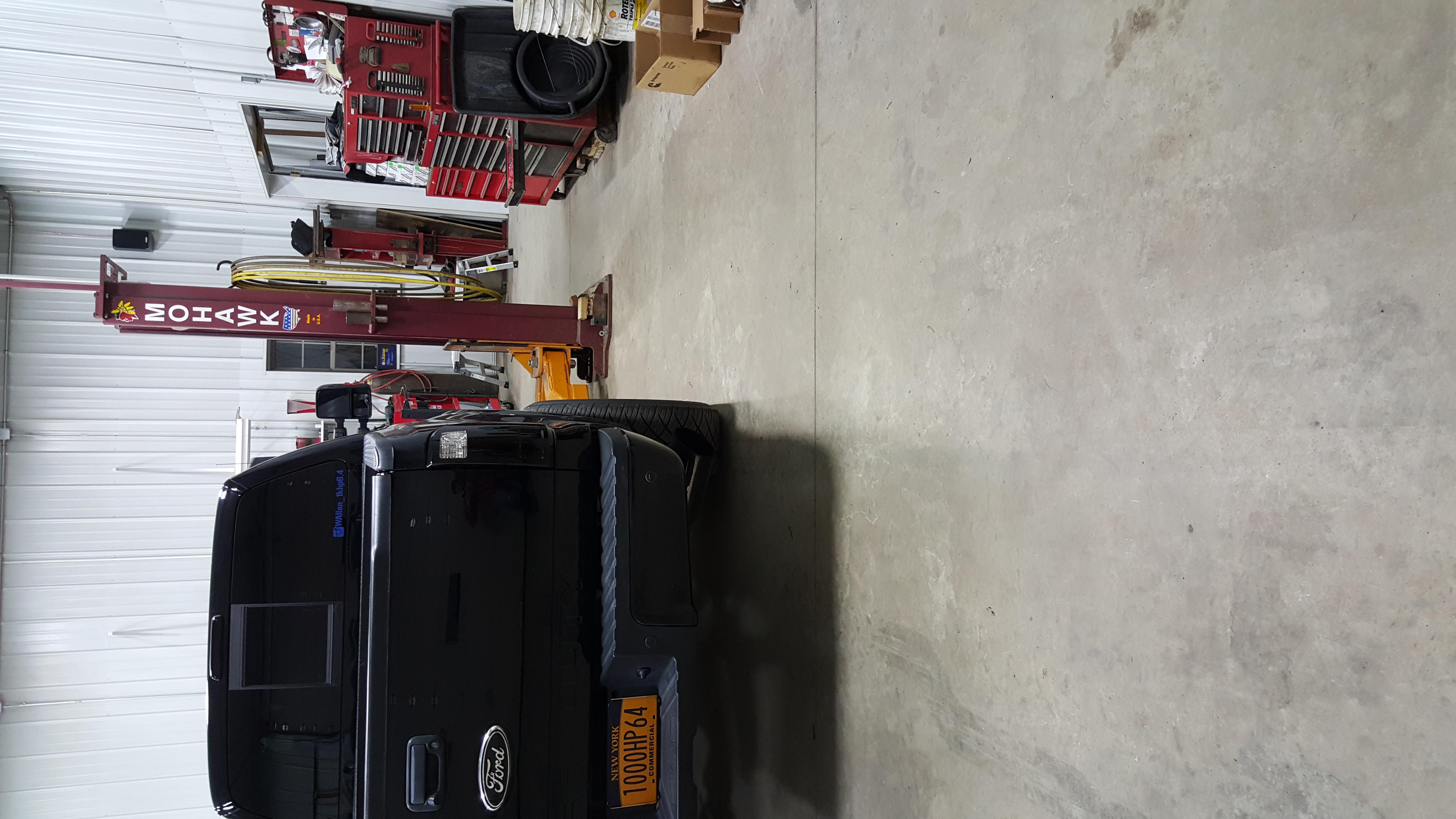

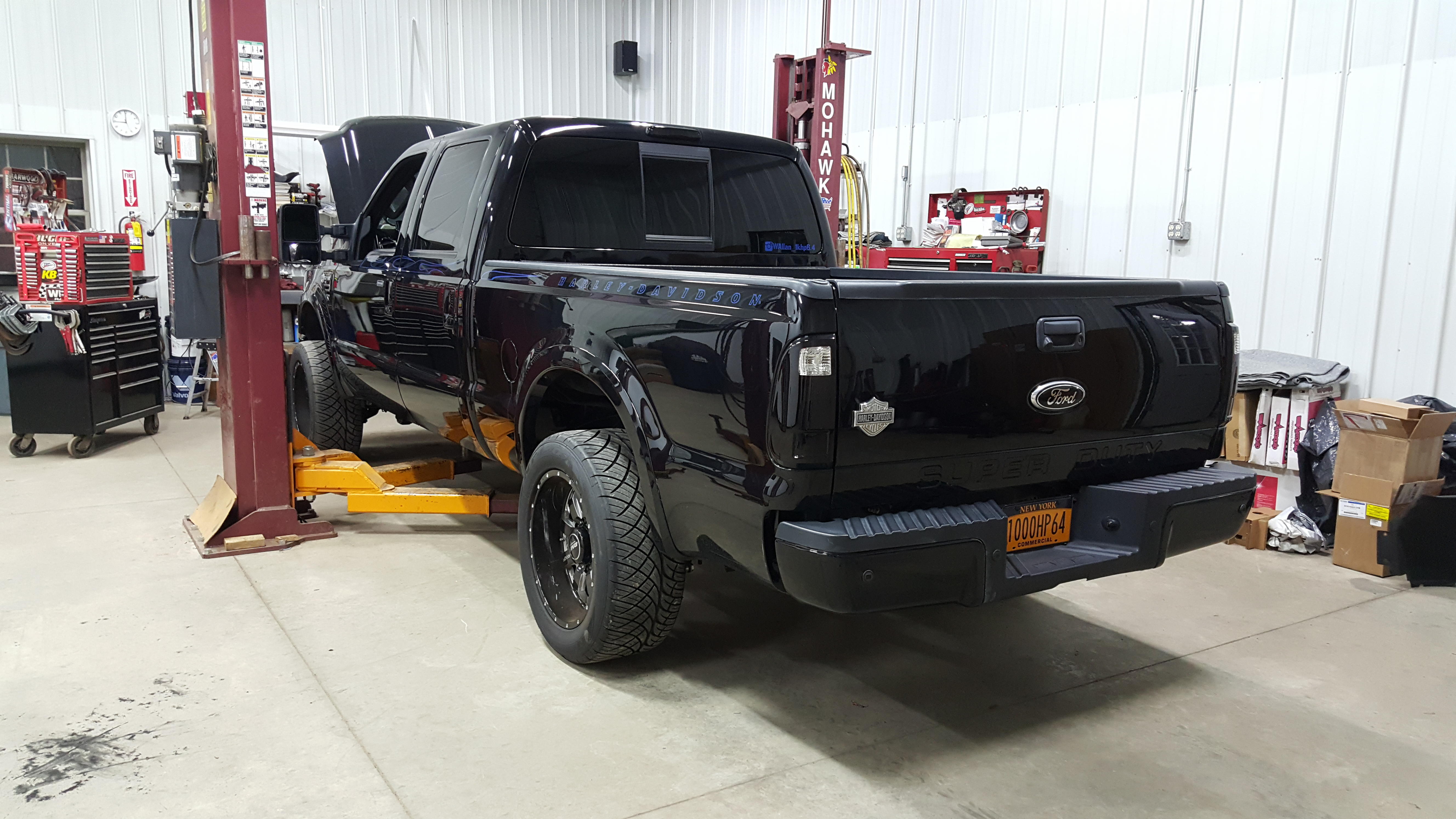

The truck was getting some love this weekend. 2 new fuel pumps went on, both from Sunrise Ford. One of which actually appeared to be new and not a reman, no signs of use at all. The other one was obviously different with different packaging and bolts/nuts covering the ports. Injectors came back from Rykan Holder with a clean bill of health. Truck is currently running. Onnly issue that my buddy ran into was the 4 link kit I picked up seems to push the front axle too far forward, about an inch too far to be exact. So that is getting modified and will be on in the next day or so. Can't wait to get it back, it's been down since September!

The truck has been sitting outside since it broke, it actually has a lot of dust and grime on it right now. The paint has plenty of blemishes and imperfections, after all it is driven quite a bit and has 100k on it. But clean and in the right light it looks awesome. Thanks guys! Just stopped by today quick. He just got done fabbing and mounting a windshield washer reservoir which we've been meaning to do since the turbo set up was done.
