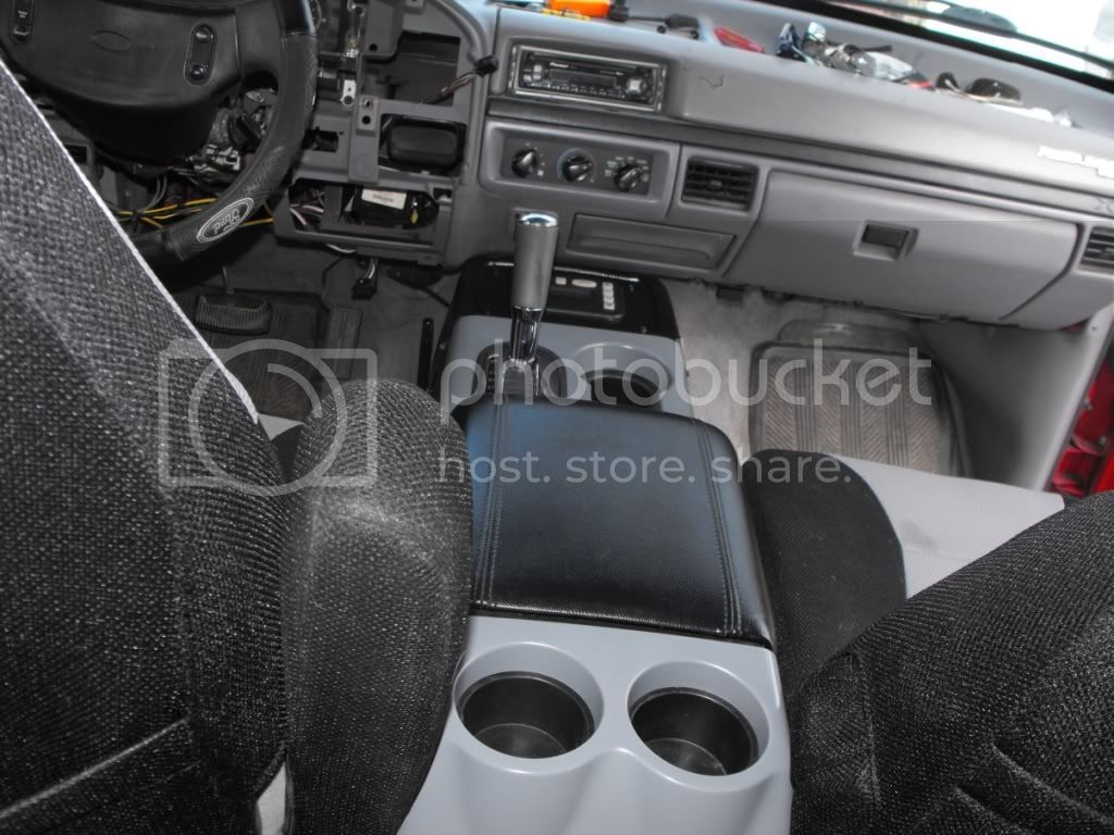

Yeah. I know a F-150 center console with a console shifter has been put into an OBS and looks factory, but its still missing the manual mode.
Or you could do the 150 console shifter, and just put a toggle, or a couple buttons for the PCS controls. Or somehow put a rocker switch onto the shifter lever its self. IDK how functional it would be, but it could be done to look factory.
What year console f150's? THe Floor sifter can be made to work in this application. Do you have a linky or a pic of this done ?

Shane(Fordman247365) did the mod, its an 04-08 150 console. Not sure if he is on this forum.
http://www.powerstroke.org/forum/94...4-08-f150-center-console-shifter-96-f350.html
